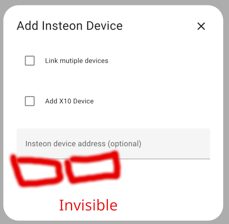

Can someone post a pic of Device Add dialog
No matter what OS or browser I have tried I cannot see the buttons on the Insteon Add Device dialog. I can see by hovering the mouse there must be two buttons but have no way of know which button is which. Please provide a screenshot of what the dialog is supposed to look like.

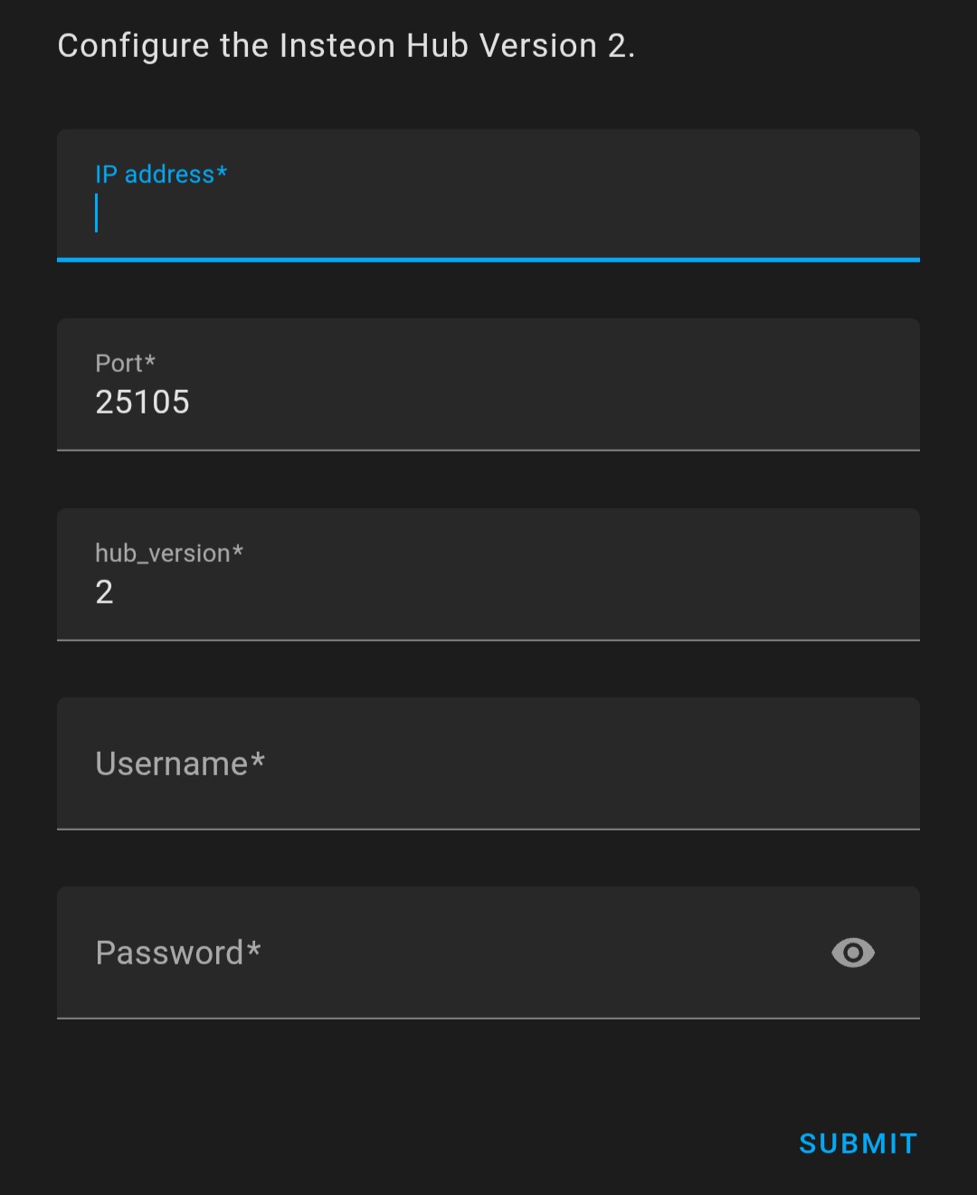

Did you read this post yet? It might help you!
That’s the wrong dialog. Please see my screenshot. I need to know what the two invisible buttons do.

Thank you, that does provide me a lot of information but I am unable to pick out a label name or icon name that helps me knnow what each of the two invisible buttons do (I know they are there as I get a “shadow” when hovering over them).
I have captured the html but I’m afraid it may be too much to paste here. If the code would help you to point me in the right direction how should I provide it?

EDIT: @emvigelis might have found the answer for you in the meantime thanks to Google images! The screenshot is from 2022 (missing the x10 option), but the button layout should still be the same.
@ShadowFist ,
Thank you very much! You Google kung fu is obviosly better than mine. Each button responds exactly as the screenshot you found states.
