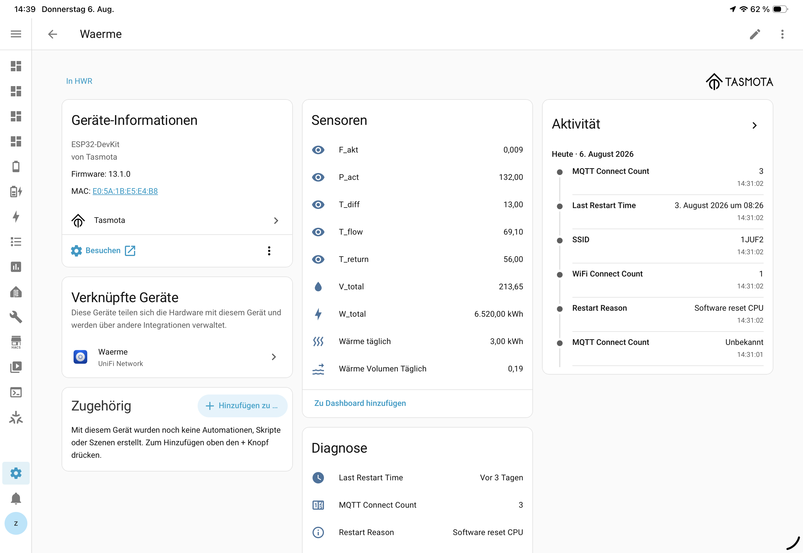

Can’t add unit m3 via customize.yaml
I try to add units to my heat measurement.
At my configuration.yaml i have
homeassistant:
  customize: !include customize.yaml
At the customize.yaml
sensor.hwr_waerme_waerme_w_total:
    unique_id: Wärme_Gesamtverbrauch
    device_class: energy
    unit_of_measurement: "kWh"
    state_class: total_increasing
sensor.hwr_waerme_waerme_v_total:
    unique_id: Wärme_Volume
    device_class: water
    unit of measurement: m3
sensor.hwr_waerme_warme_taglich:
    unique_id: Wärme_Tagesverbrauch
    state_class: total
sensor.hwr_waerme_warme_volumen_taglich:
    unique_id: Wärme_Tagesvolumen
    device_class: water
    unit of measurement: "m3"
    state_class: total
And i can see the at the Tasmota integration
Why the kWh will work and the m3 not?
Thx for any hint :slight_smile:

Nonetheless, I can see your issue anyway.
m3 is not a valid unit of measurement
The 3 needs to be a superscript character. Sorry I can’t type it when I’m on my phone, but you can copy it from this page:

Thx, but this don’t resolve the problem.
Have put in now „m³“ :person_shrugging:t3:

Is it now better?
Try
  - name: HWR Wärme Wärme V Total
    device_class: water
    unit_of_measurement: m³
  device_class: water
  unit_of_measurement: "m³"
  state_class: total
  device_class: water
  state_class: total
Well that it
I don’t copy the „_“
THX
