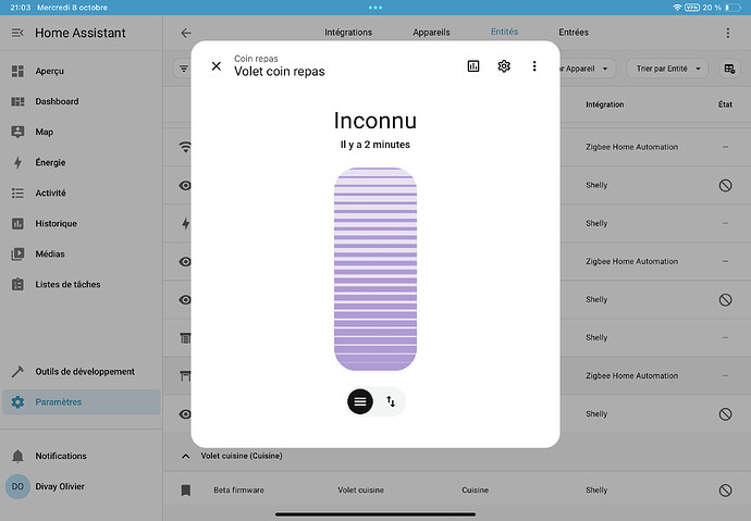

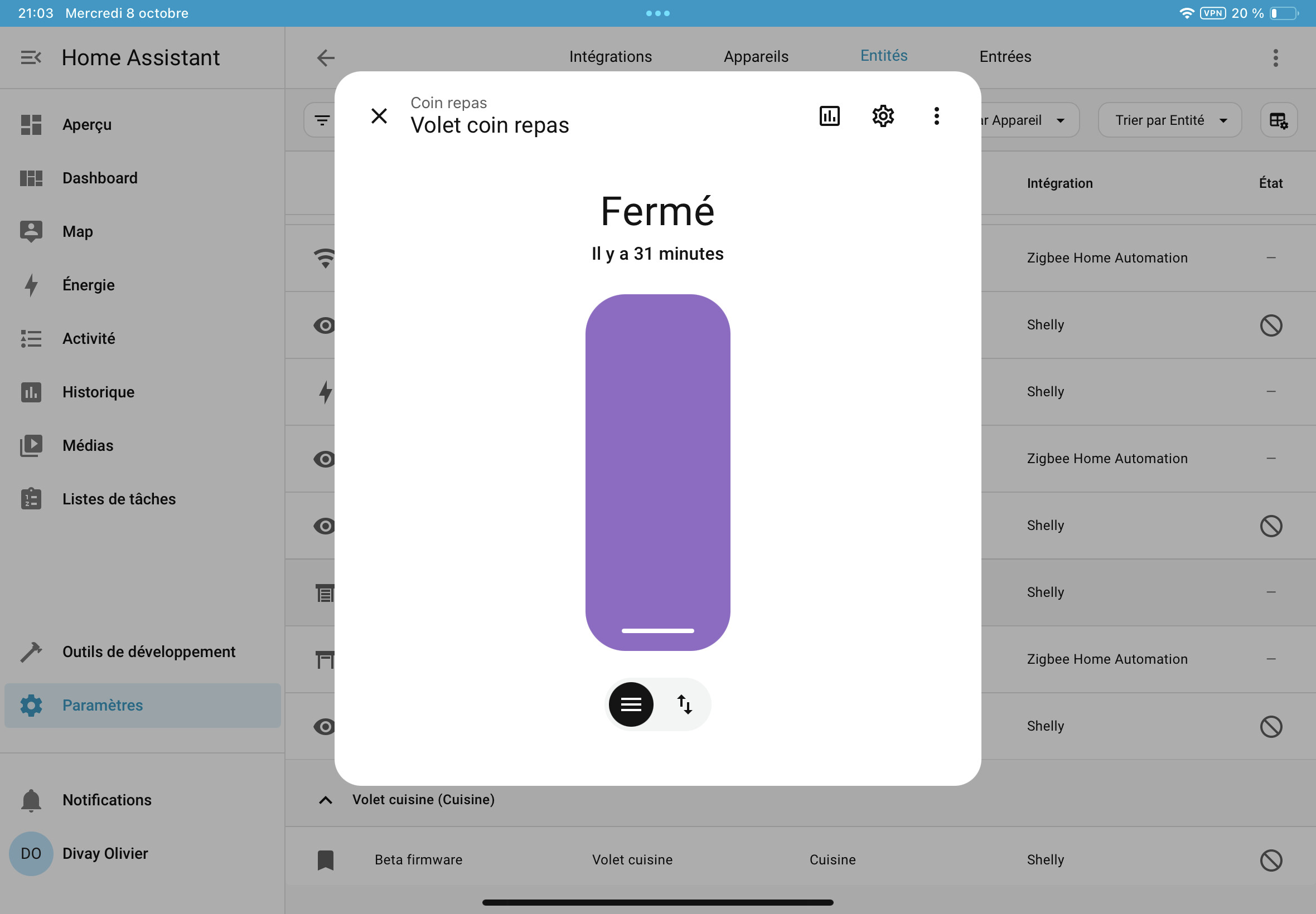

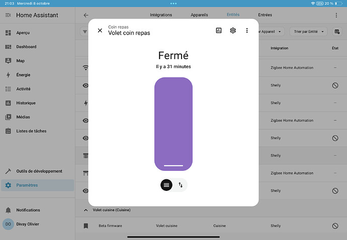

However, while it works great as a Shelly intégration (it is recognized as a rollershutter in my case), ZHA defaults to controling shutter tilt (which fails with an error). I can’t figure out how to fix this.
Here goes with ZHA intégration:
And here goes with Shelly intégration:

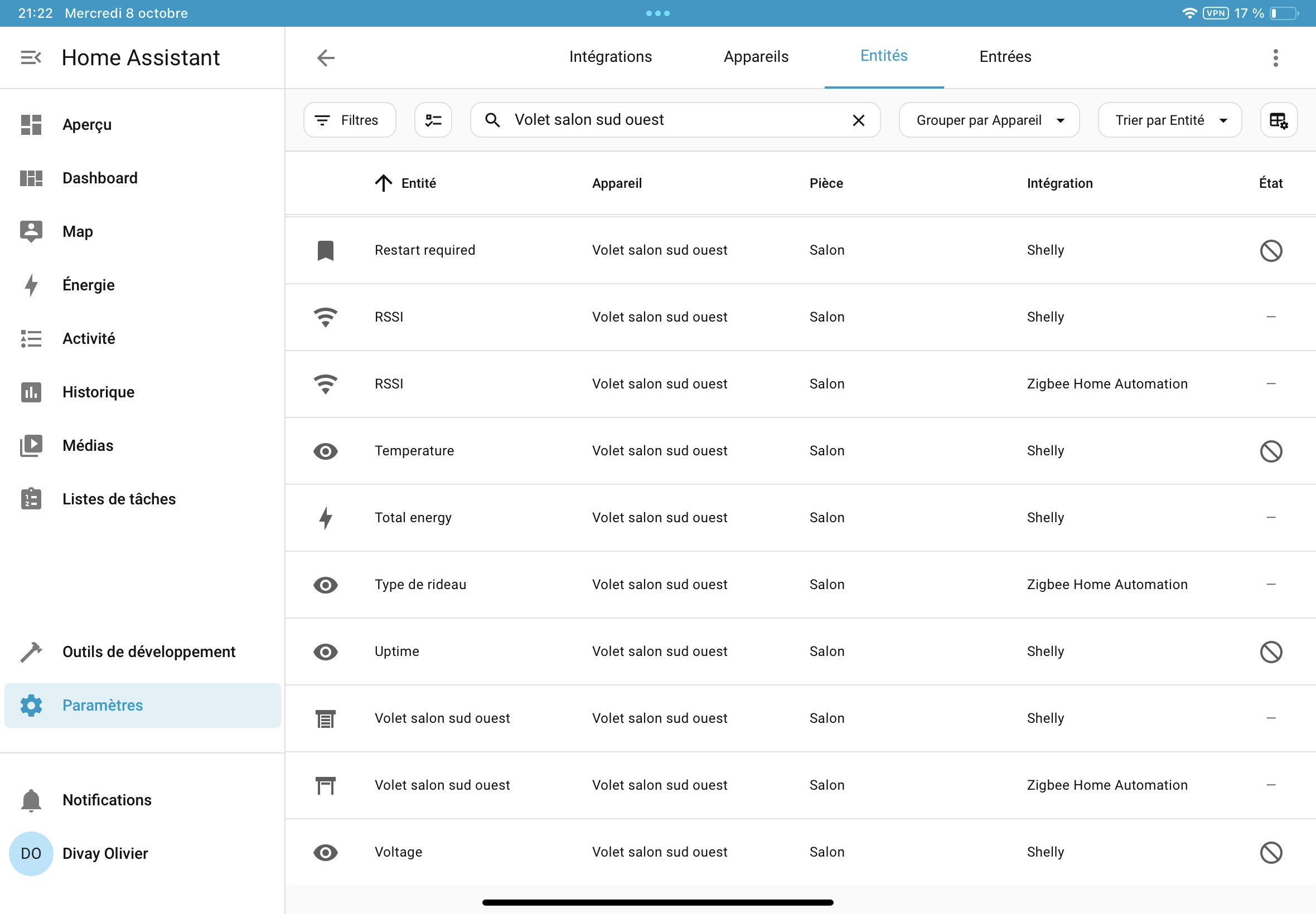

Interestingly, there is 1 Shelly device out of 5 Where ZHA gets it right, but I can’t tell the configuration difference.
