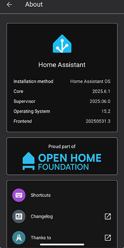

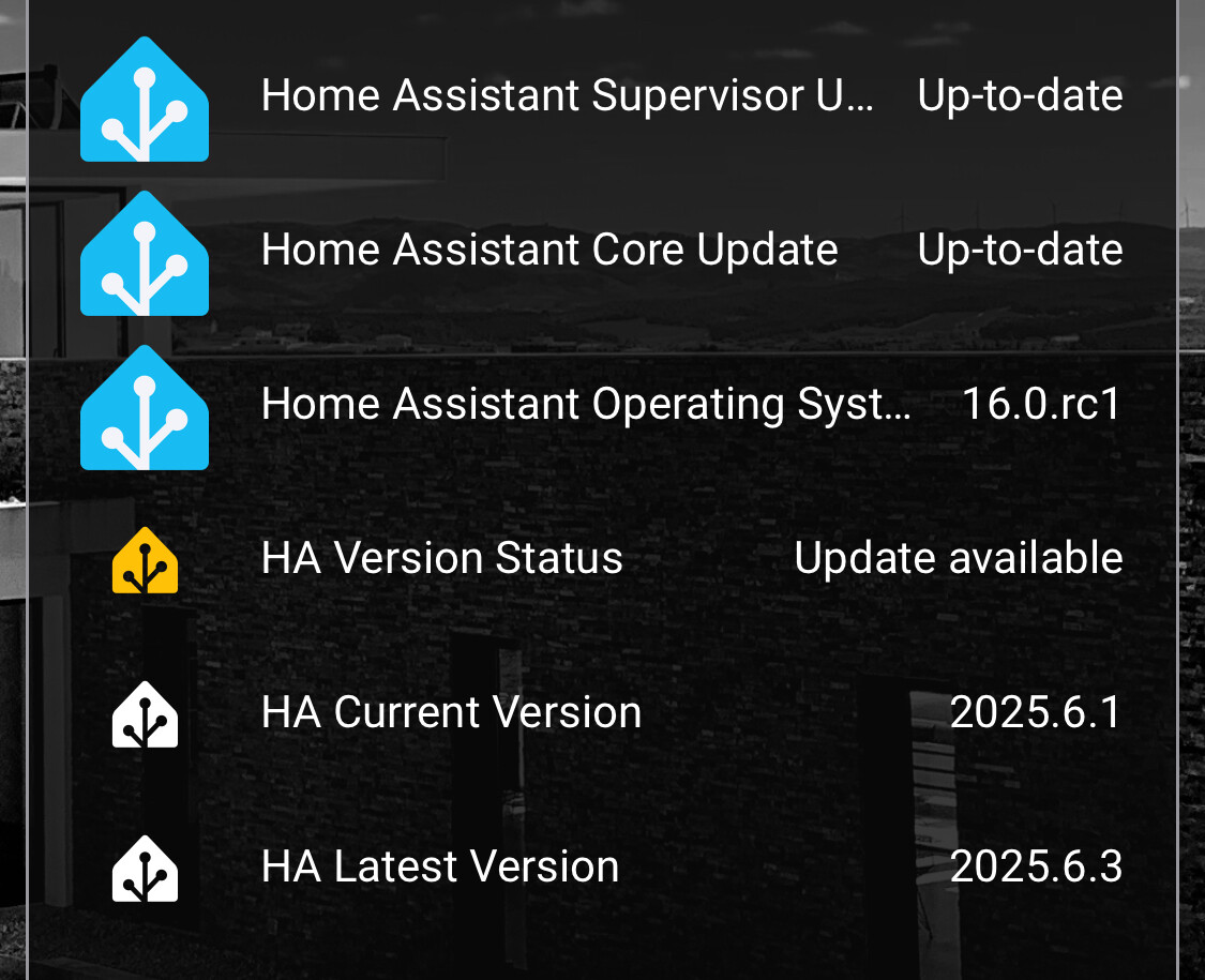

I seem to have an update issue updating my HA core. I have a remote setup connecting to instances together. Once an update is available I update both.
What happened since 2025.6.1 is that I get updates for my remote instance but my main instance doesn’t get updates anymore. I can search for updates but it doesn’t pick up any. I know the update exist but it doesn’t appear.
In the setting parts I have searched for updates but I don’t get any.
What is the spook here? Any ideas?
