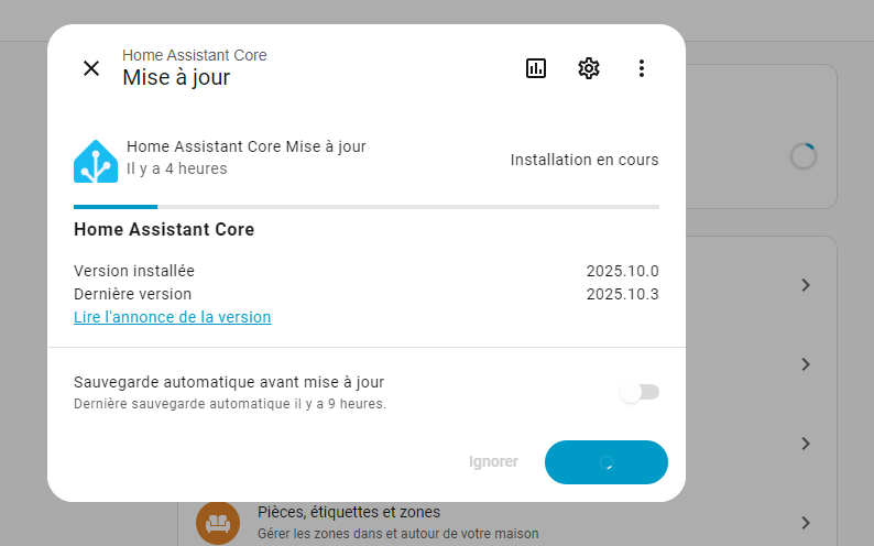

Dear all,
I can’t upgrade to 2025.10.3
Every time I try, it will pretend it’s doing it, until I come back later and nothing has changed.

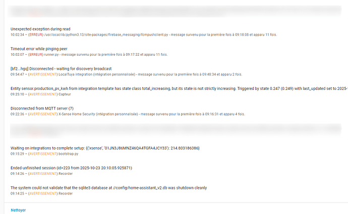

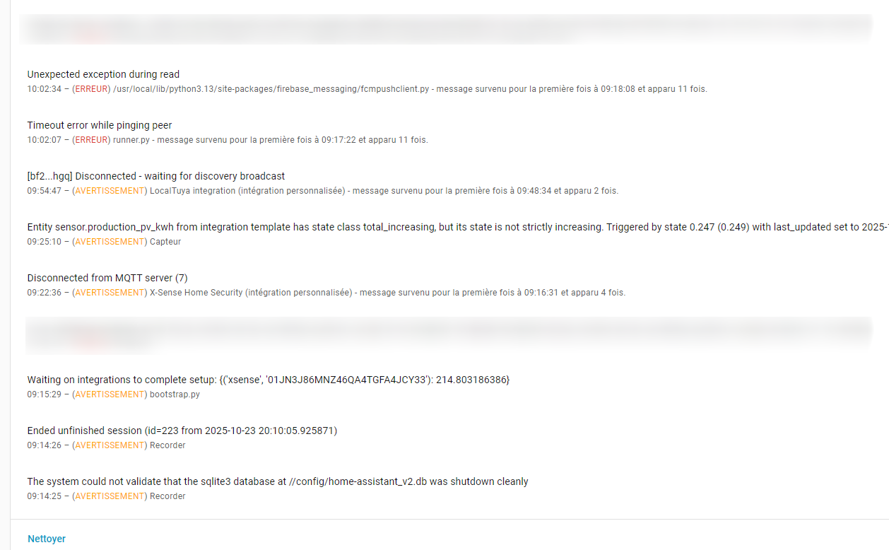

Here are my logs. I am unsure if the message about sqlite3 can be the problem.
For the record, installed on a Raspberry Pi, using official power supply.
Many thanks for any insight you may have !
On that page select the supervisor log and share that.
Looks like you pulled the power without shutting HA down first. Don’t do that. It’s a sure-fire way to corrupt your system.

I don’t see any attempt to update in either the core or supervisor log.
It happened at 9am today.
I can assure you it did not. I am at home since yesterday and had no power failure nor did I try to touch the Pi.
I tryed to update just before 09:00 am.
Would this mean there is a problem with the power supply ?
More likely DNS.
I’ve tried another time at 13:36 :
But nothing seems to appear in the logs at that time.

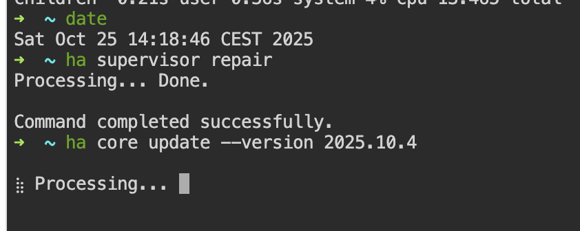

Try this at the HA CLI:
ha core update --version 2025.10.4
Thanks again for your time and help.
I tryed this command around 09:30, after 3 hours the system is back but nothing changes.
Here are the logs.

Show the core logs.
2025-10-25 08:10:35.261 INFO (MainThread) [homeassistant.components.automation.ecran_cuisine_on_si_presence_jour] Écran cuisine ON si présence (jour): Running automation actions
2025-10-25 08:10:35.274 INFO (MainThread) [homeassistant.components.automation.ecran_cuisine_on_si_presence_jour] Écran cuisine ON si présence (jour): Executing step call service
2025-10-25 08:11:03.111 WARNING (MainThread) [homeassistant.components.hassio.coordinator] Could not fetch info for a0d7b954_ssh: Timeout connecting to Supervisor
2025-10-25 08:11:07.804 WARNING (MainThread) [custom_components.xsense.mqtt] Disconnected from MQTT server (7)
2025-10-25 08:11:07.909 WARNING (MainThread) [custom_components.localtuya.common] [bf2...hgq] Disconnected - waiting for discovery broadcast
2025-10-25 08:11:07.916 WARNING (MainThread) [custom_components.localtuya.common] [bf4...mva] Disconnected - waiting for discovery broadcast
2025-10-25 08:11:07.939 WARNING (MainThread) [custom_components.localtuya.common] [bfa...4wo] Disconnected - waiting for discovery broadcast
2025-10-25 08:11:07.948 WARNING (MainThread) [custom_components.localtuya.common] [bf3...h9p] Disconnected - waiting for discovery broadcast
2025-10-25 08:11:07.960 INFO (MainThread) [hass_nabucasa.iot] Timeout while waiting to receive message
2025-10-25 08:11:08.063 ERROR (MainThread) [homeassistant.components.rest.data] Timeout while fetching data: http://192.168.1.30/api/get?action=periph.value&periph_id=188971&api_user=9yi643&api_secret=vfRYfzi36dftTChy
2025-10-25 08:11:08.139 WARNING (MainThread) [homeassistant.components.rest.util] Empty reply found when expecting JSON data
2025-10-25 08:11:08.337 ERROR (MainThread) [homeassistant.components.hassio.handler] Timeout on /core/info request
2025-10-25 08:11:08.339 ERROR (MainThread) [homeassistant.components.hassio.handler] Timeout on /supervisor/info request
2025-10-25 08:11:08.342 ERROR (MainThread) [homeassistant.components.hassio.handler] Timeout on /os/info request
2025-10-25 08:11:08.344 ERROR (MainThread) [homeassistant.components.hassio.handler] Timeout on /network/info request
2025-10-25 08:11:08.376 WARNING (MainThread) [custom_components.localtuya.common] [bf6...urn] Disconnected - waiting for discovery broadcast
2025-10-25 08:11:08.378 WARNING (MainThread) [custom_components.localtuya.common] [bff...yos] Disconnected - waiting for discovery broadcast
2025-10-25 08:11:08.769 INFO (MainThread) [custom_components.localtuya.common] [bf2...hgq] Trying to connect to 192.168.1.130...
2025-10-25 08:11:08.879 INFO (MainThread) [custom_components.localtuya.common] [bff...yos] Trying to connect to 192.168.1.5...
2025-10-25 08:11:14.364 ERROR (MainThread) [homeassistant] Error doing job: Task exception was never retrieved (None)

Again there is no attempt to update logged.
What version are you updating from?
You could try a supervisor repair but I suspect there is something more seriously wrong with your system, do you have a recent backup?
ha supervisor repair
then
It’s unbelievable.
I tried at 14:18 and for 4 hours, the system was unreachable.
