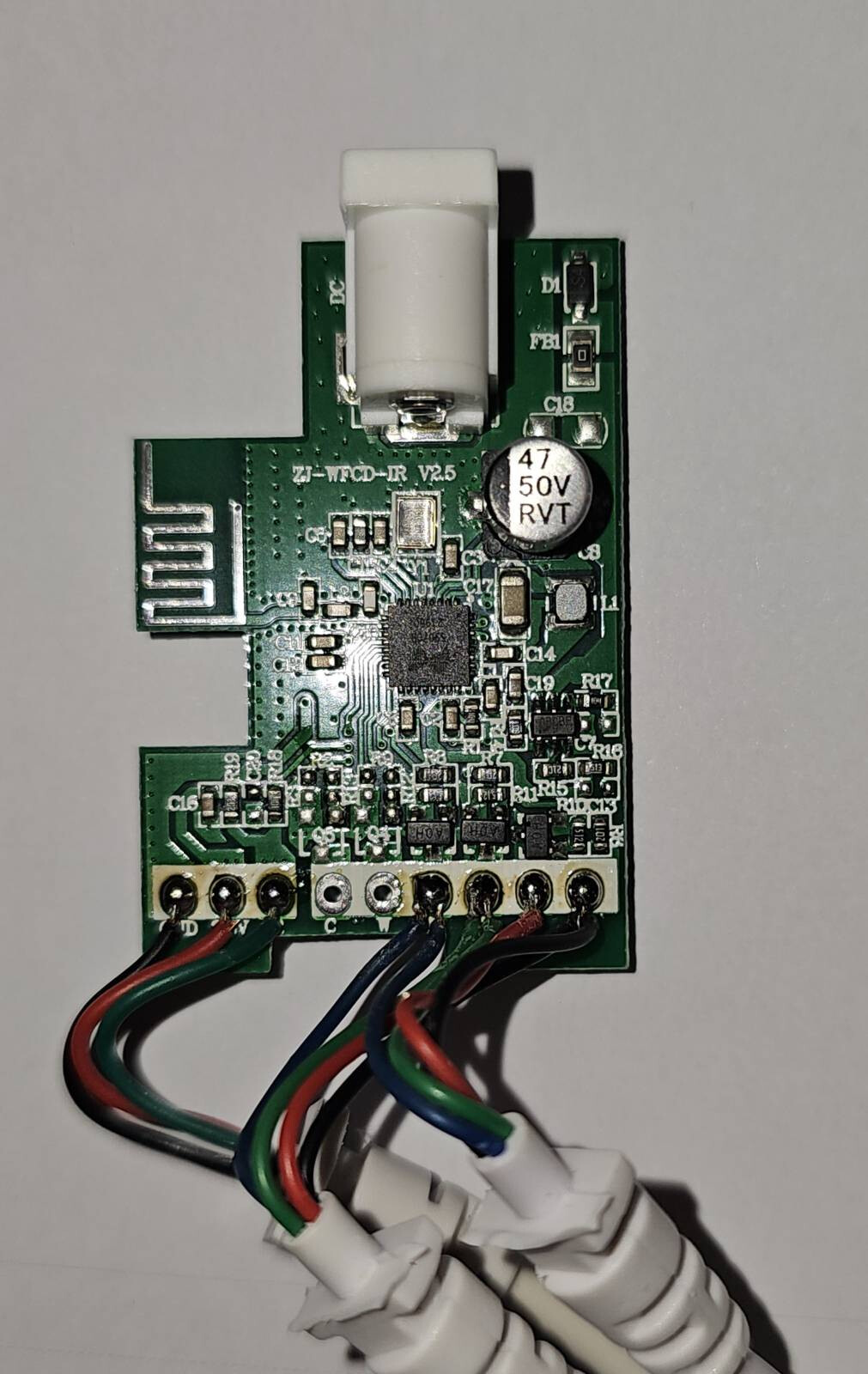

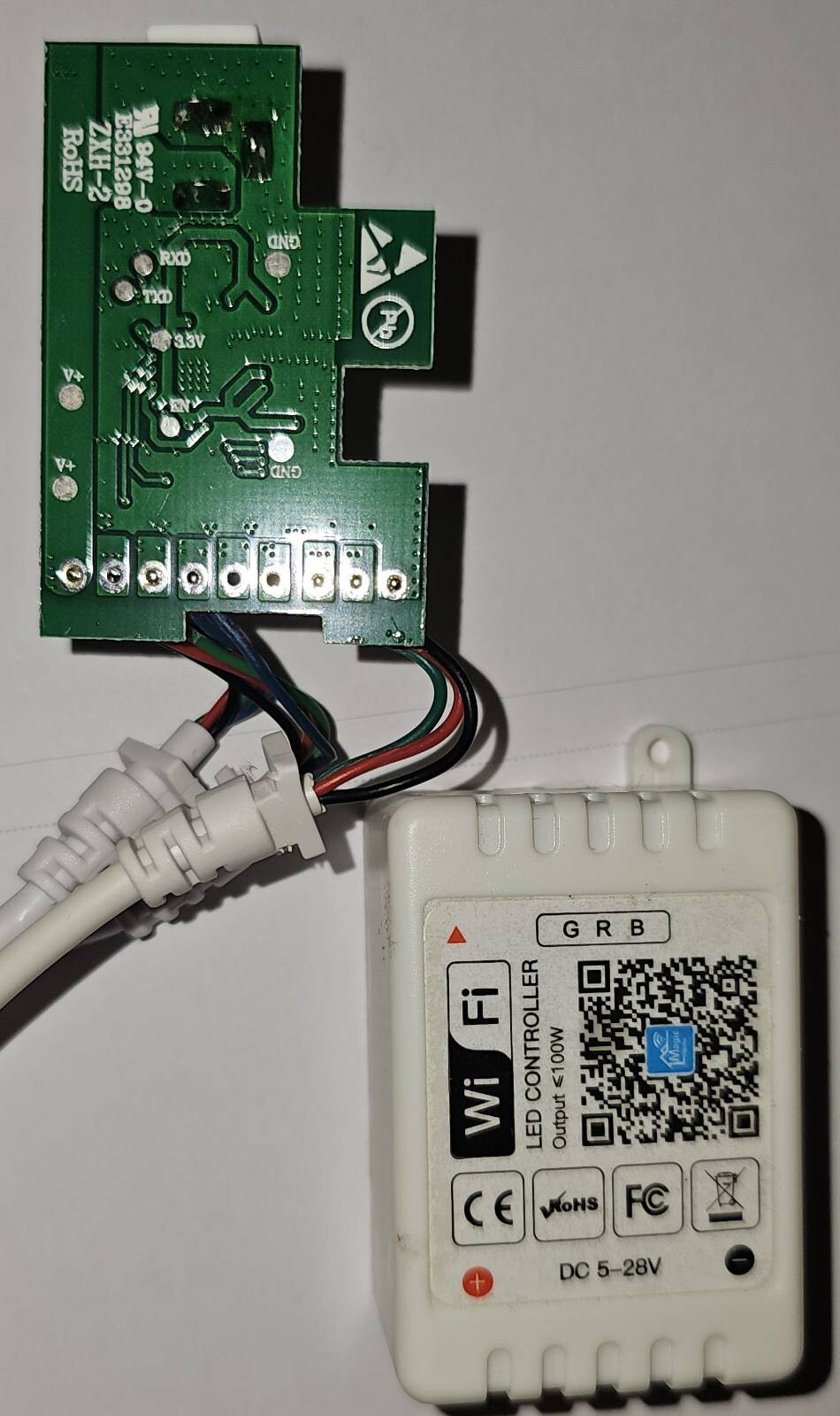

I have this led strip controller and I wanted to ask if it can be flashed by ESPHome?
This is an old one I bought years ago but it can be found here .
On the board there these pins: 3.3V, GND, RXD, TXD, EN
Also the chip in the middle has this: s908708 21950
On the PCB there are:
ZJ-WFcd-IR V2.5
94V-0 ZXH-2 RoHS
I found this: Flashing my Magic Home LED strip controller - #7 by finity
but that’s a version with one output. It should’t matter because the remote controls both outputs but the version is still
Thanks.
I also found it this but that one is different version and I have EN pin instead of GPIO0. I don’t understand it enough to say if it’s the same as I found that the EN pin is resetting.

So take a magnifying glass and have a look at the markings on the chip (if any).

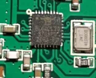

Same chip, different angle…

I don’t know if it wasn’t clear from my post but I already included that in my initial text.

Is it a BL602 chip bit difficult to make out on the photos. If it is do your research as projects affiliated to the BK72xx mention it, but I’d probably look elsewhere.
Doesn’t look like the usually realtek or beken. Maybe bouffalo?

I managed to get a clear picture. The 8 may be a B but also that didn’t help me find anything.
Karosm
(Karosm)
November 2, 2025, 11:16pm
12
No it wasn’t clear.
s908708 vs s9070b.

probably a BL602. Most MagicHome devices are. Often theyre seen with a Leapfive LF686 marked chip, which is just a BL602.
Did you capture boot log from TX pin?
