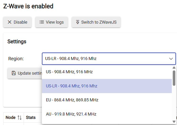

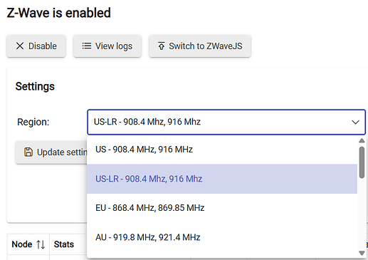

But first you might see if you can switch to Z-Wave JS directly in the Hubitat and then make an NVM backup. Then you could restore it directly to your new controller with Z-Wave JS.
Or, if the Hubitat has a way to export the NVM that might work.
Restoring the NVM means you don’t need to re-include the devices.

Z-Wave JS can convert NVM formats, as long as the SDK version is v6.61 (I believe) and up.
