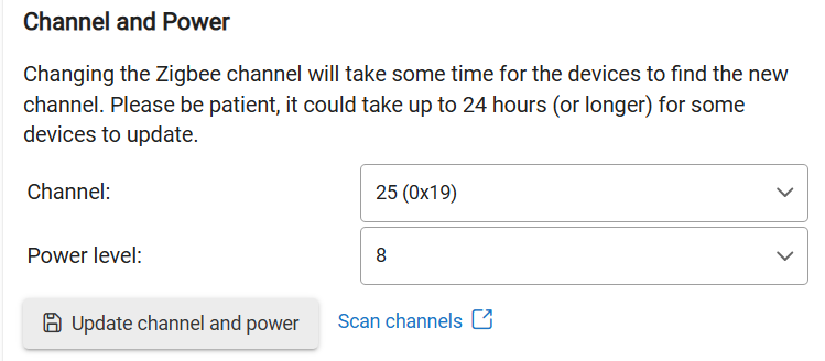

But I’d like to get a ZBT-1 so I can access Zigbee devices directly from the Green. If I do this I would guess I need to configure Zigbee on the HA on a different channel than the Hubitat?

Thanks. That’s good I wanted them separate. So I’ll install the ZBT-1, then change it to a channel different than Hubitat’s 25. And then be able to add devices without affecting the Hubitat Zigbee mesh.
