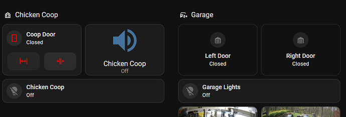

So, all functions in this one work fine, except I can not figure out how to make the status track as I’d like: open, opening, closed, closing. I assume that is in my configuration.yaml, and even as I follow others leads, I always get: opened 100% or closed only.

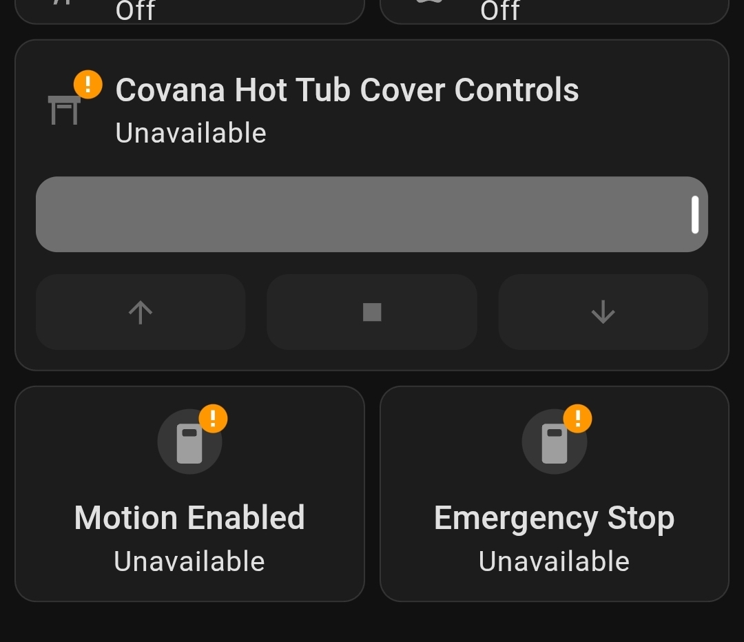

Im doing a hot tub cover lifter right now and I’m building everything including the safety lockout into the esp32. It will expose two buttons (the momentary Deadman, and e-stop) and the cover control itself. This also meets my requirement that the safety is in the hardware as close to the actual actor as possible…
I’ve got no custom code behind those buttons it’s all in the esp logic with that cover. Maybe that helps?
