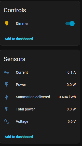

The Samotech has a built in voltage and energy meter and I have noticed that the voltage drops almost to zero when the lights are at full brightness which is when the flickering happens, when I set the dimmer to 75% the voltage is just above 30v and the lights don’t flicker.
