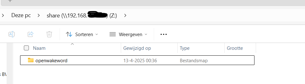

Do you have one of the SSH add-ons installed, or the Samba server ?
I do have Samba share installed, yes. I forgot about that. When I go to the shared network drive I see one folder that I shared at one point:
EDIT: I managed to setup a new share and now I have access to all files. Hopefully I can now just change my configuration.yaml and all will be good. Thanks so far!
EDIT2: fixed, thanks again
