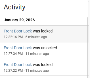

Mine just shows lock/unlock status, but not how it was accessed. Not sure if the app has more detailed logging, as I never set it up. Here’s what I see in HA:
