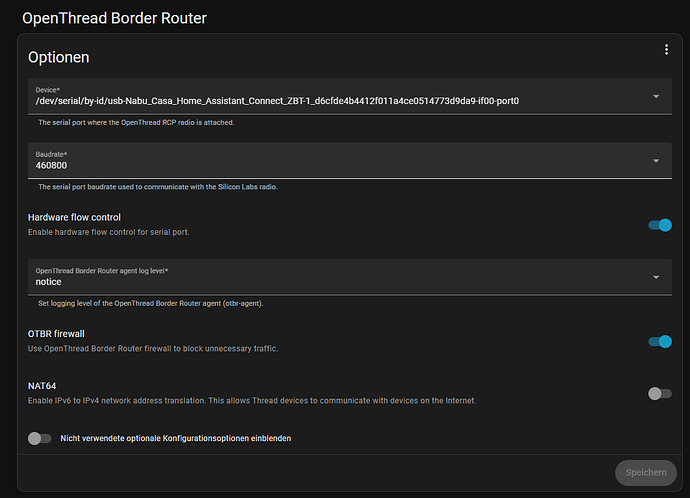

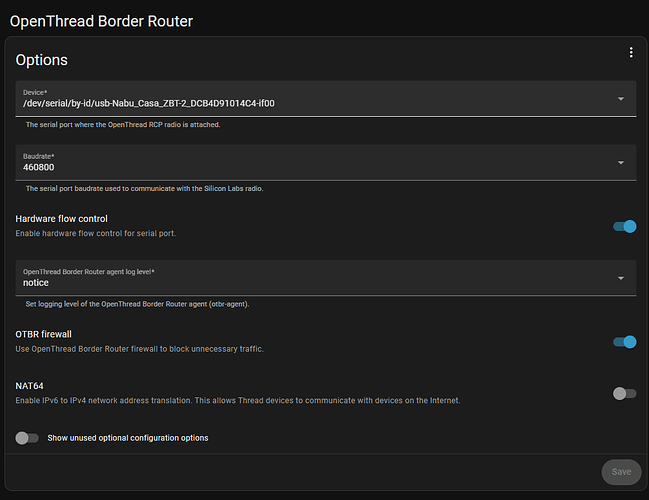

Did you setup the border router giving it the ZBT-2 stick (similar to this)
Except for the device name?
/dev/serial/by-id/usb-Nabu_Casa_ZBT-2_DCB4D91014C4-if00
Thanks for the help :slight_smile: i reinstalled all the add-ons and started all over, and now it works :slight_smile:
