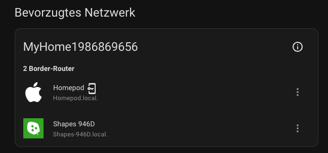

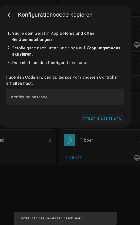

i successfully added my thread network to HASS but i cannot add the lights (already paired with the nanoleaf app and homekit) when i trigger the pairing mode in homekit and copy the provided code to HASS.
Instantly it shows the error: cannot add. There is no delay it is really instantly right when i click the “add” button …

I can ping6 google.com from inside the docker container and because the thread boarder routers where detected i don’t think there’s too much wrong with my ipv6 setup …
