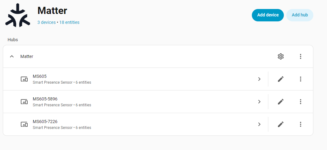

I was able to add two MS605 sensors:
And they are functional.
