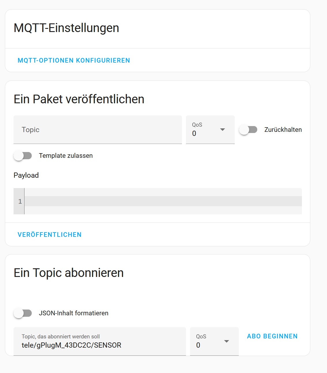

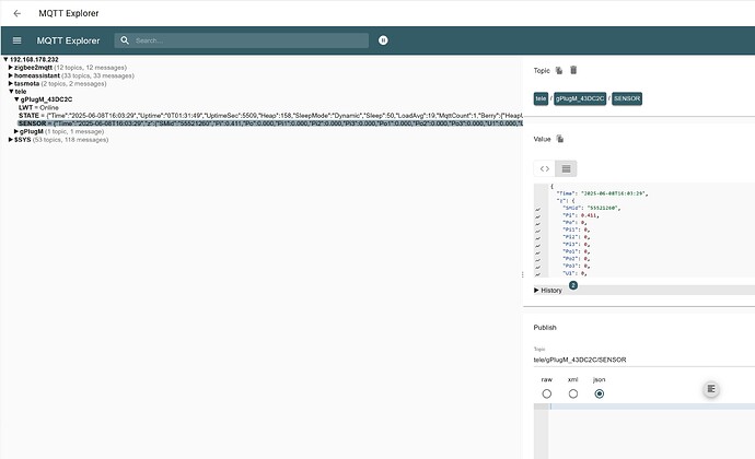

Having a look into MQTT withe the explorer I see some exchange. However on Home Assistant I do not se the data/entities.
Many thanks for your tips/help

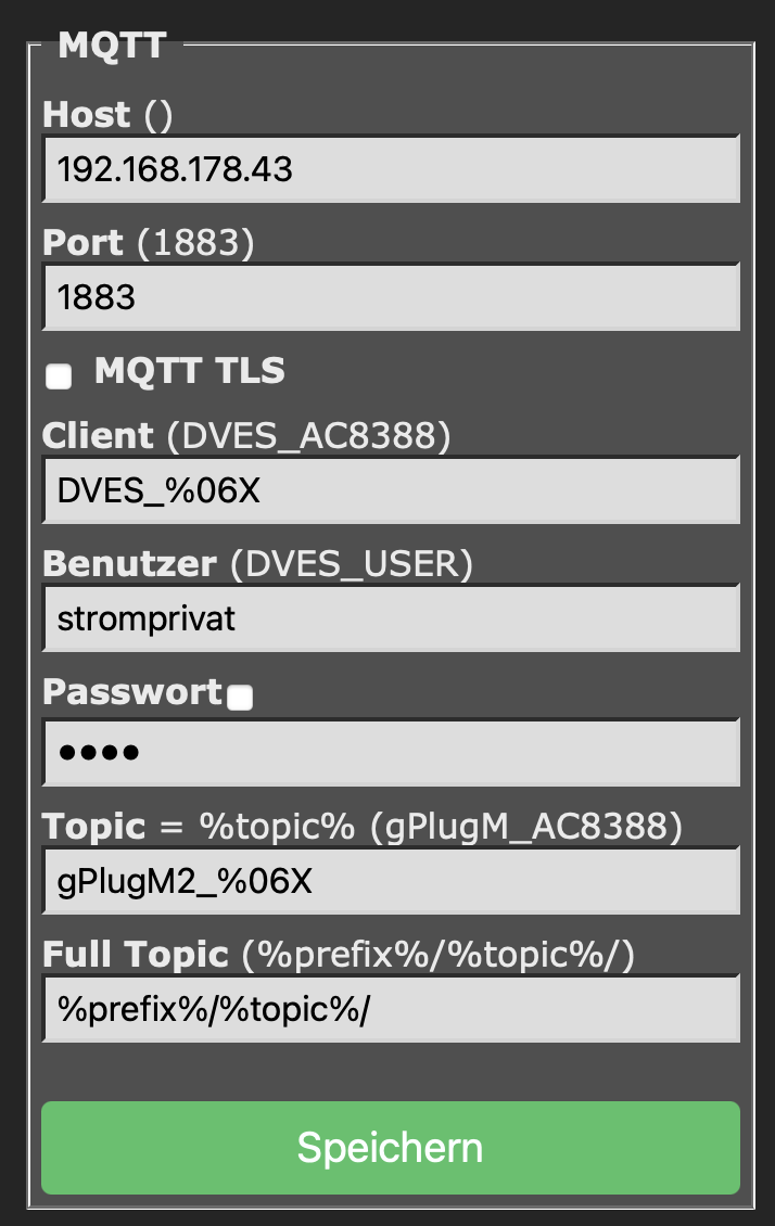

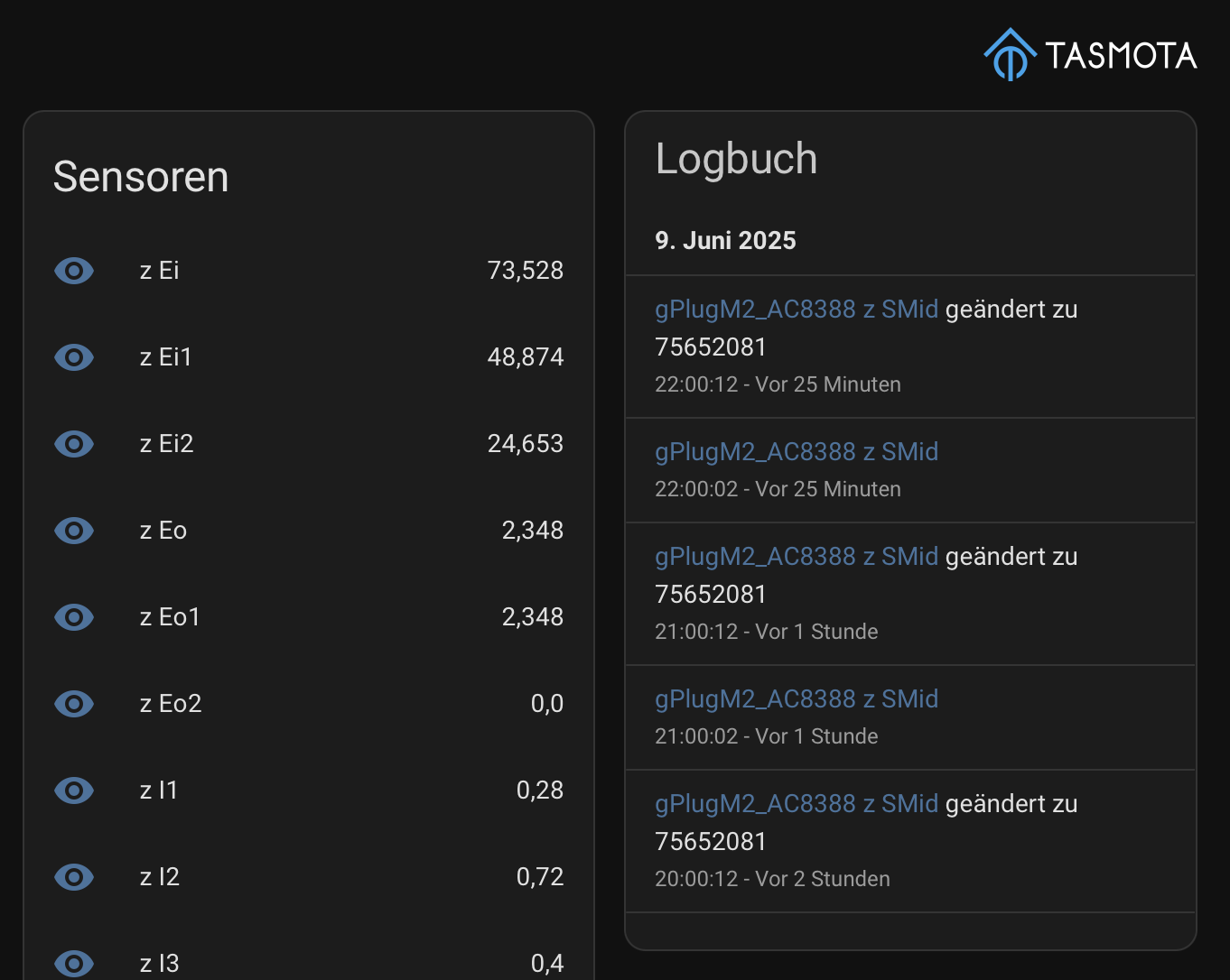

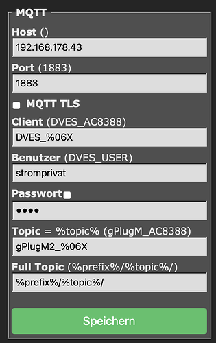

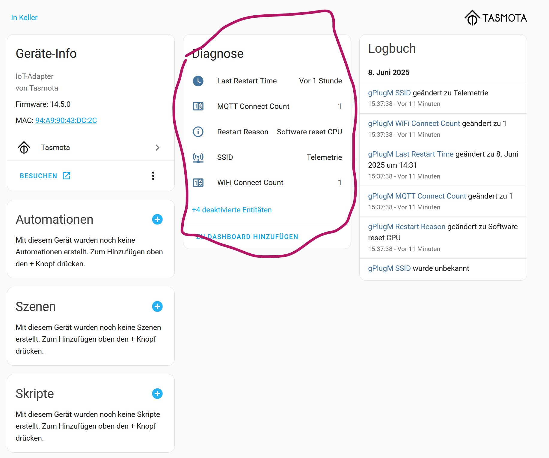

Hello Hans Peter

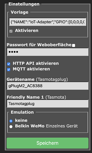

After playing around for a long time, I had already given up. When I returned to the Home Assistant after a few days, I discovered some new data in the Tasmota. Now I just have to give them the right unit and it seams to work.
It looks like that in the Tasmota Integration:
On the Tasmota Device I use the following settings:
I hope it’ll help you.

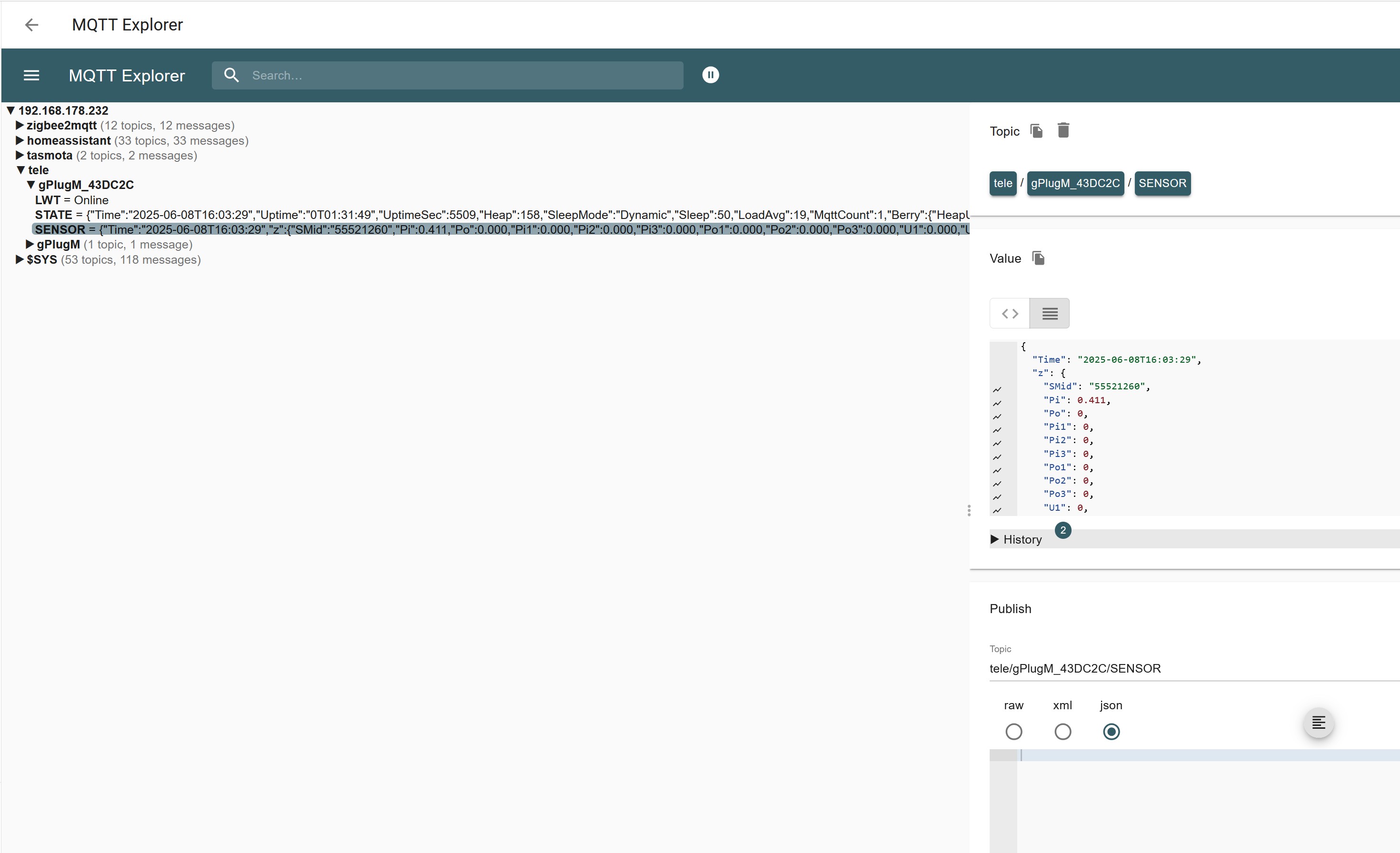

Good afternoon,

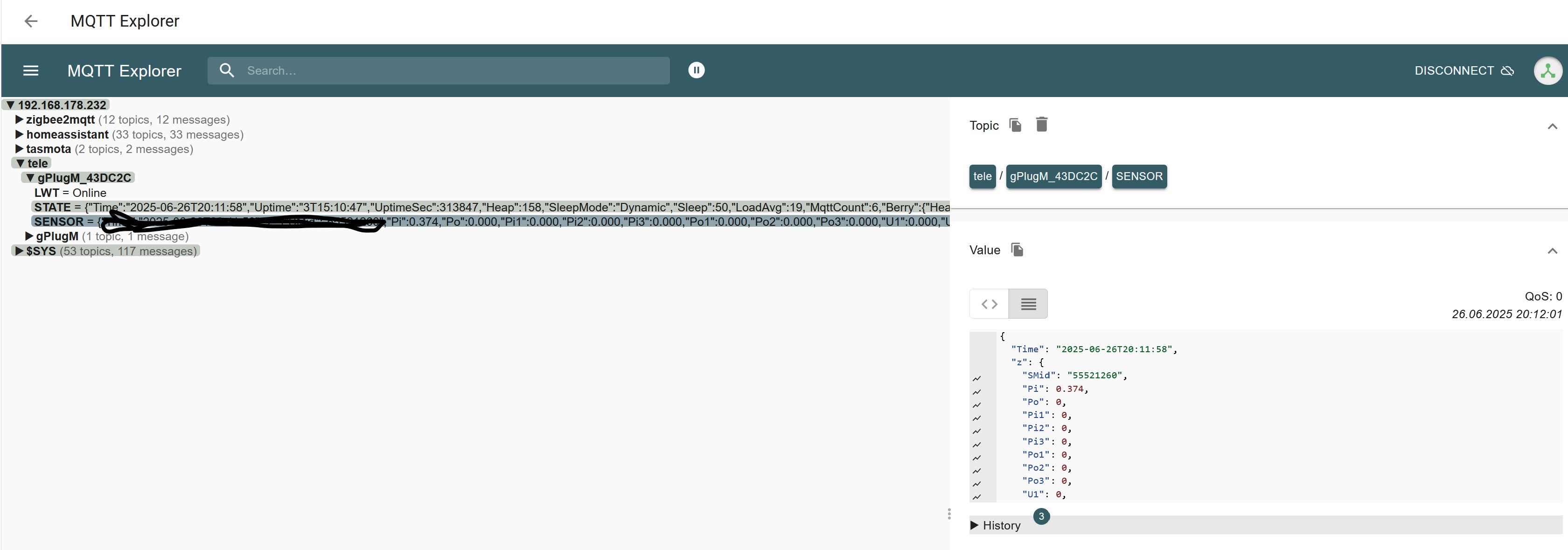

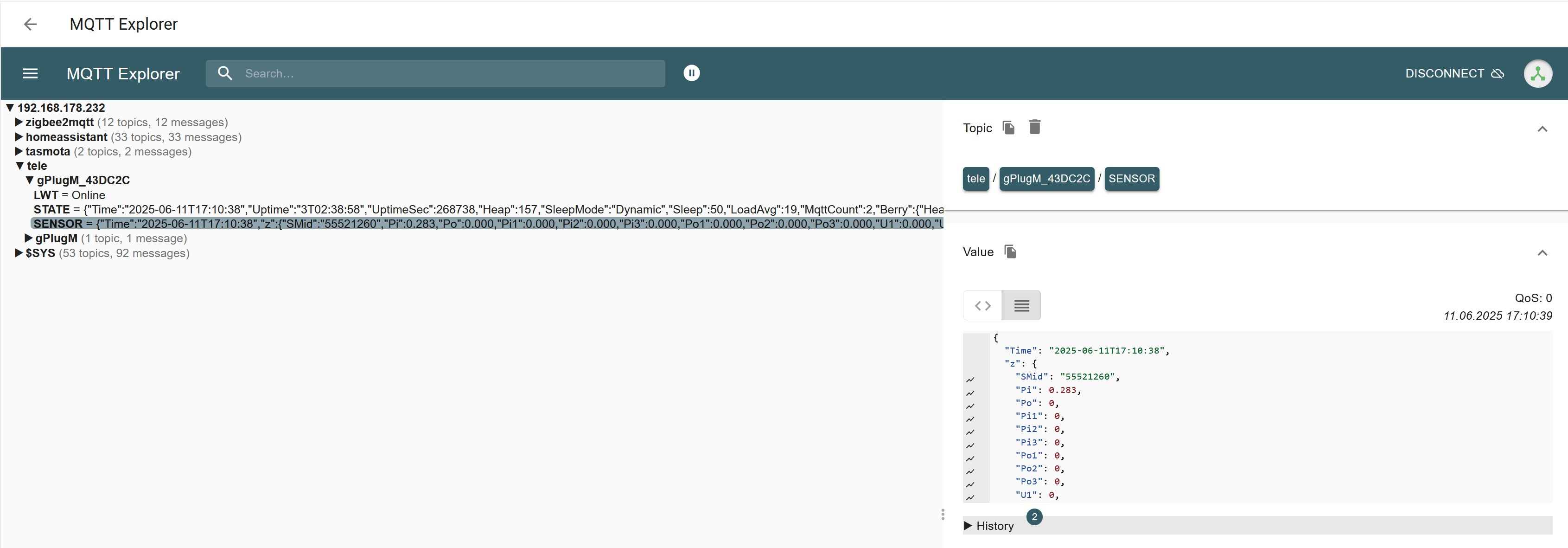

Great to hear, that you managed to solve the problem. I also found a solution (together with a good working colleague). Your Tasmota configuration looks similar as mine. Also the tasmota script on the gPlugM. In a first step I installed the MQTT explorer on Home Assistant. There I found/saw the topic from gPlugM.
For me, this is/was a confirmation, the the data from the smartmeter a arrived on MQTT. The question for me and my colleague was: Where are the correspinding entities on home assistant. My colleague knows HA for some years. From his point of view the question was: How doese HA subscribe the required topics. Well, actually it seems that certain topics (beginning with “homeassistant” will be automatically subscribed (you may have a look at MQTT explorer). In My case, the Topic “tele/gPlugM_43DC2C” was not subscribed at that time. We did that on MQTT. After that, isaw like you the entities on the tasmota Integration.
In conclusion:
  • The gPlugM device with it’s generic setup/configuration works well (The support from the vendor/producer “Gantrisch Energie AG” is really good.
  • Actually I use the generic Configuration on the gPlugM Device (I am waiting for the offical OBIS code from Energy Thun).
  • This ist the first time, that I had to work directly with MQTT. Therefore, there is some documention work to do (for me).

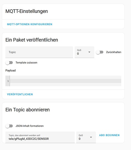

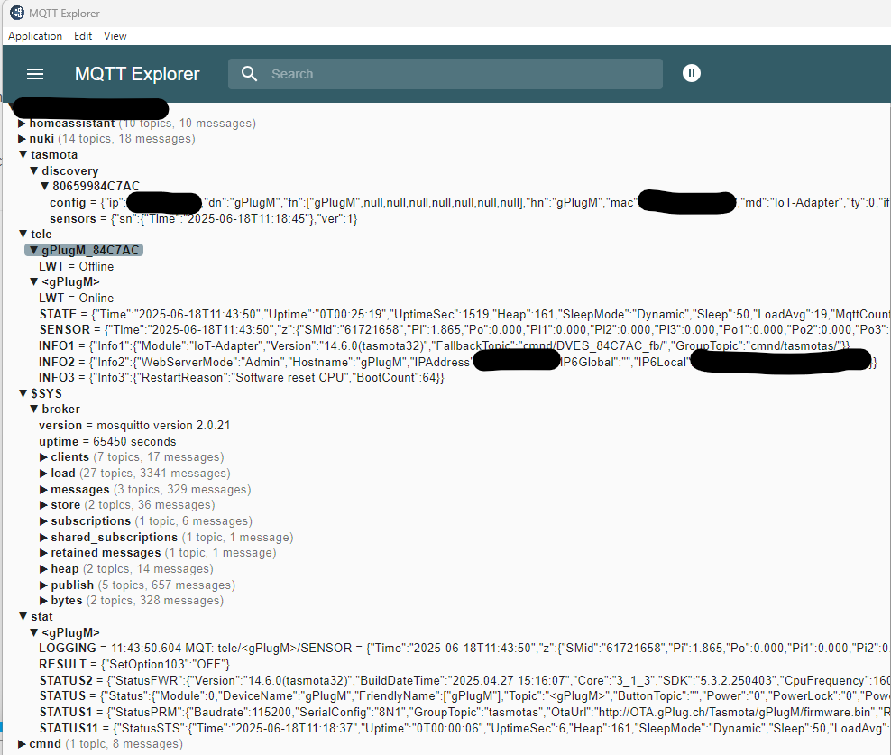

Hi Hans Peter
Can you perhaps briefly explain to me how you did the subscribe? i have been struggling with exactly the same problem since switching from the amsreader firmware to the tasmota version.
Good evening, sorry for the delay.
I was on a trip. Your question concerning the subscription of a topic:
First I got the correct topic from the MQTT explorer. There you’ll find the required topic (below you see "my2 topc). In your case, i suppose the required topic would be “tele\gPlugM_84C7AC\SENSOR”
You may copy the topic and use it for the subscription in the MQTT integration.
I got this hint from a colleague. In the HA documentation I found, that topics beginning “homeassistant” will be automatically subscribed. All other topics must be manually in MQTT subscribed.
Hope this helps :slight_smile:
