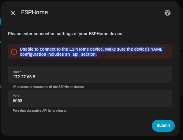

Cannot connect to ESPHome device over WireGuard VPN – “Unable to connect to the ESPHome device” error
I’m trying to add my ESP32 device to Home Assistant using its VPN IP address from WireGuard.
However, when I enter the VPN IP as the host address, I get the following error message:
Unable to connect to the ESPHome device. Make sure the device’s YAML configuration includes an `api` section.
Here’s what I’ve set up so far:
  • Installed the WireGuard Add-on from the official Home Assistant add-on store
  • The ESP32 is running ESPHome with the built-in WireGuard client enabled
  • I can’t ping to the IP address: 172.27.66.5 from HA server

Has anyone successfully connected an ESPHome device through a VPN like this?
Any suggestions on what configuration might be missing or blocking the connection would be greatly appreciated :pray:
I spent two days on this and finally fixed it, I hope I can help. The root cause is that Home Assistant runs in one container and WireGuard in another, so traffic entering the WireGuard tunnel ( wg0 ) doesn’t automatically reach HA’s container network or your LAN. You must enable IP forwarding and add proper iptables rules on the WireGuard server to allow forwarding and NAT, so packets from VPN clients can reach the HA container (and the LAN) and get replies.
In the WireGuard server config, under “Server” add the following in PostUp:
iptables -t nat -A POSTROUTING -o wg0 -j MASQUERADE; iptables -A FORWARD -i wg0 -j ACCEPT; iptables -A FORWARD -o wg0 -m conntrack --ctstate RELATED,ESTABLISHED -j ACCEPT
and in PostDown:
iptables -t nat -D POSTROUTING -o wg0 -j MASQUERADE; iptables -D FORWARD -i wg0 -j ACCEPT; iptables -D FORWARD -o wg0 -m conntrack --ctstate RELATED,ESTABLISHED -j ACCEPT
AI suggested me some version of this fix, so try with this o use AI to suggest similar configuration that could be good for your general settings and please update me if this worked for you.
