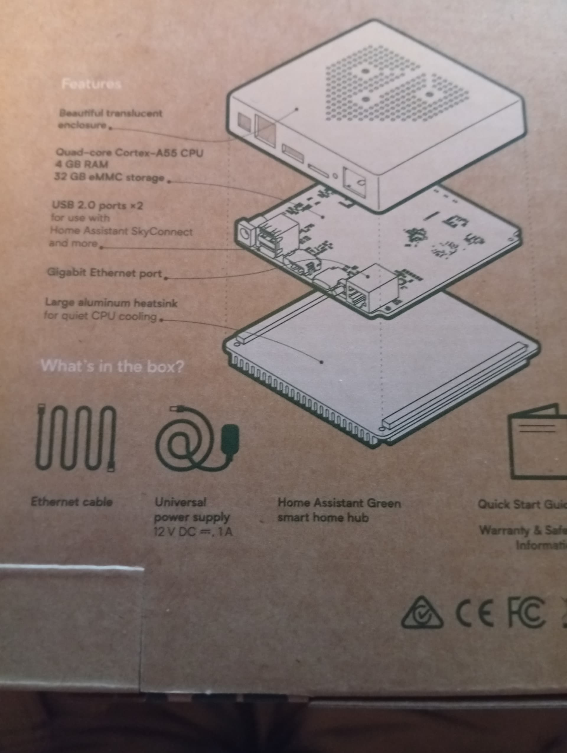

I believe Green is less than a PI, max output on 1 usb-port(2.0) is 1A, on a Green , and the " Power-Supply" which comes with it is ofcause also only providing 1A … Bonus it hadly uses any Power :laughing:
Power supply for green is 12v @ 1A: 12W
Power output from usb is 5v @ 1A: 5W.
There’s an additional 7W used to power the green & other stuff. It’s not running on free energy :wink:
I have no idea what your “point” with your commend is, and Yes there’s nothing wrong with my “Math” capabilities, and i do also have a power-meter, so im TOTALLY aware how much my Green “Draw” ( Including under load such as Nightly backup and monthly updates etc ) … beside all my other Utilities and Devices
Another “off Topic” is, i dont have de-sampled it just for adding a battery, And i Also have had 3-4 “Powercut’s” First one as a test "to see if it came online again when power came back, and 2-3 "accidently " fu ,
And I Never had issues, neither DNS, NTP or other “network” related , with my Green :wink: :wink: :wink:
BTW. it has 2 usb ports :wink: count the W again … that is if you have any intention of drawing full load on both
