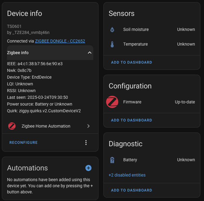

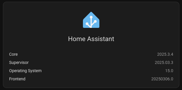

Also these are my current system versions
apologies I replied to the wrong message in the thread, let me know if there’s anything else I can provide to assist :slight_smile:
ok for the first time I finally see the quirk has taken hold
So it’s working now? If you still get unknown values, try a single short press the button on your sensor to wake it up & force it to send an update.
so it now at least detects the quirk and applies it to my device, now I would assume my troubleshooting will be to find the right device and ID. I just couldn’t for the life of me understand why I couldn’t get my device to detect the quirk. does this also mean that I can’t keep the quirk folder organised at all?
