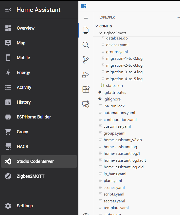

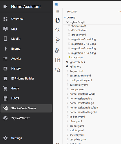

You can install an app like Studio Code Server to get the file accessible through your web browser. Looks like this when you use it:

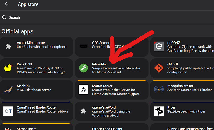

There is also an official app called File editor that you can find under Settings → Apps
