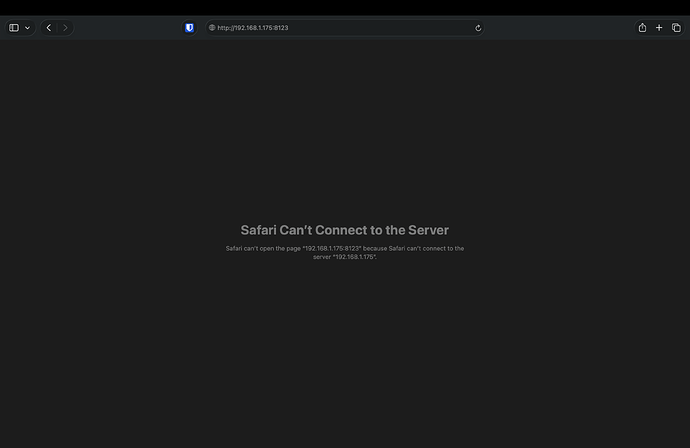

Can you show a screenshot? What browser(s)? attach the screen capture using the graphic icon located just to the right of the coding block (< / >).
Did you install SSL certificates?
I have tried safari and Firefox on my MacBook Air and chrome on another pc. On the Macbook it says that safari cannot connect to the server.

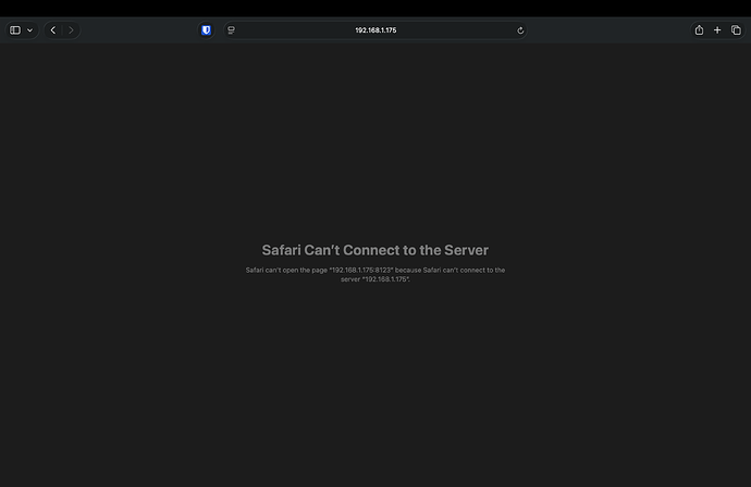

Where is the :8123?
I tried using 8123 port but it shows the same message. HA companion app on my iPhone keeps searching for the device on the network but cannot find it. I tried reinstalling HA app on iPhone, blocking location access but still cannot connect.
How are you over riding the browsers for https versus http ? You normally have to setup an exception for that address and port in the browser for using http
Here is the address I typed.
