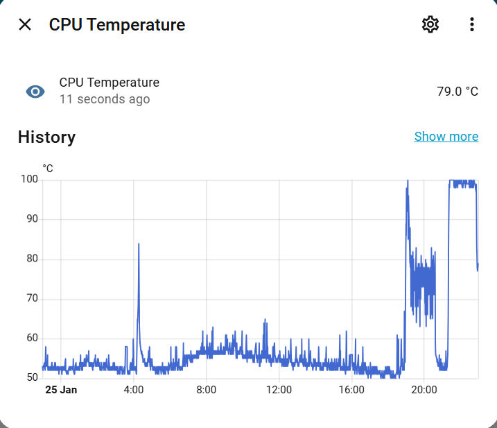

just updated esphome to the 2026.02 update and also updated watchmon, upon restart the HA was actiing mega sluggish, so i pulled the power on my nuc and powered up again, i can ping the ip, i can access samba share through my pc, but the ui is just saying loading data and not doing much of anything, i did try to ssh into it but i cannot bloody remember my password for it, any way i can get in? ive tried to get in via my dns server and through the ip address direct but no joy

i managed to get in, i deleted watchmon from the samba share, pulled power to the nuc, and then it loaded right up, my cpu temp was maxed out at 100c so it was hammering the cpu for some reason
@gazzaman2k Seems to be a bug with the new watchman update, I could only revert by removing Watchman altogether via SSH. Open Github issue is [here] (After update for the v0.8.1 2026-01-25 it briked my HA · Issue #222 · dummylabs/thewatchman · GitHub)
thx i knew it was watchmon as my temperture graph shows the moment i installed it my cpu went crazy hot
