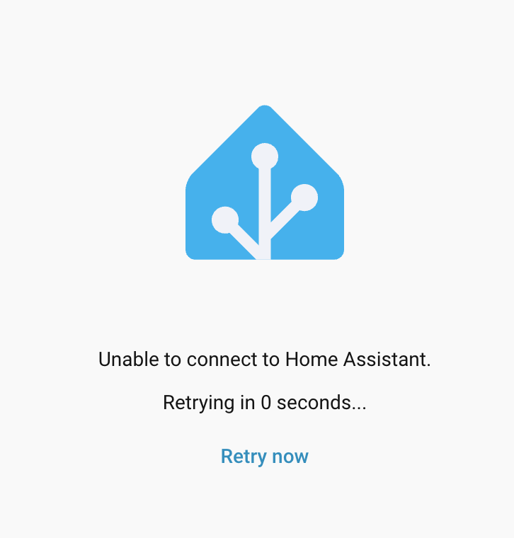

Cannot get past login when using domain name
I have an instance of Home Assistant server running on a linux server and I’m using a subdomain to access the application. I have no issues when accessing through the local ip address, but once I try with my domain name, I get to the login screen and once I try to login, I get :
I’m unable to get past this screen and I’ve searched for similar issues with no luck. I have this setup as https and http, but no luck with either. I’m not seeing any errors in the logs for this issue and that’s why I’m stumped. Any help is greatly appreciated.
