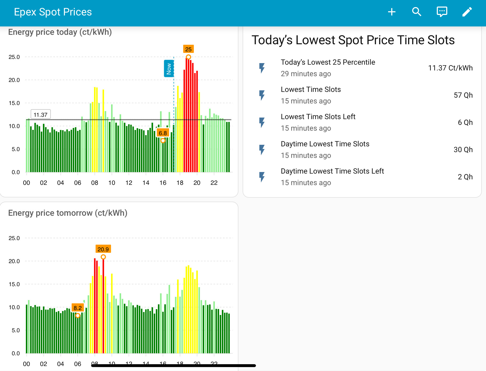

My goal is to calculate the number of time slots when the prices are cheapest per day (24hrs) and daytime (12 hrs, 06:00 - 18:00) for dynamic electricity prices.
I use this information to calculate the required average charging power over these time slots (since Oct 1st this are 15min time slots) for my home battery and PHEV when there is no surplus power from the solar panels.
Meanwhile -and thanks to your message that made me rethink what I was doing- I got this working.
Below you find my test dashboard with the dynamic prices for today and tomorrow and the calculated number of 15-minute time slots for today.
I also added the Automation YAML script. This script also contains calculations for hourly averages, but this is for testing purposes only.

Yes, I made that mistake in the first piece of code that I sent: ‘raw_today’ is indeed a list of dictionaries with a time and a value pair.
Later I realized that for the same entity there’s also a ‘today’ list attribute,so for my purpose I could simply use thar as I don’t require the time just for a count.
So in the current version of my script I’m using that list and that appears to be working just fine.
