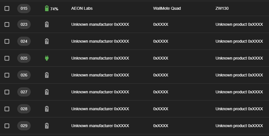

I’m really struggling with pairing an Aeotec quad remote to ZWaveJS/Home Assistant. Using a Nortek Quickstick combo, already connected to one other quadmote but that was long enough in the past that I can’t remember if I had to do anything special for.
When trying to pair, the quadmote will flash as if it’s been successfully paired, however, neither the home assistant or zwavejs UI will show a new device. If I restart zwave, it will show a bunch of failed devices (screenshot and debug logs below)
Tried this multiple times with different security settings, and can’t figure anything else out.
