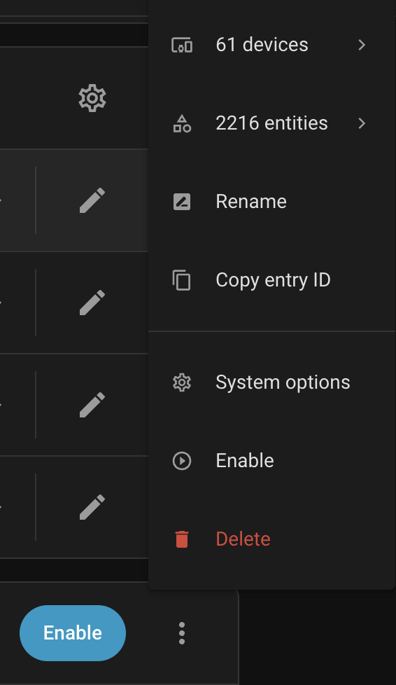

Just mostly curious. I moved one of my controllers from an add-on to a separate machine running zui. I disabled the integration in the process and set up the new zui server.
Now I want to point that config-entry to the new websocket. But with the config-entry disabled there’s no Reconfigure option.
Kind of seems like should be able to update the websocket address before enabling it.
Is it that HA can’t configure it if it’s not enabled? Or just a UI issue?

Yeah, I re-enabled and reconfiguring worked. Luckily, I had just stopped the API and disconnected the USB stick, but probably would have been a problem if I had also stopped the add-on. Or maybe not – it might just ask to get reconfigured it it couldn’t connect to the websocket.
