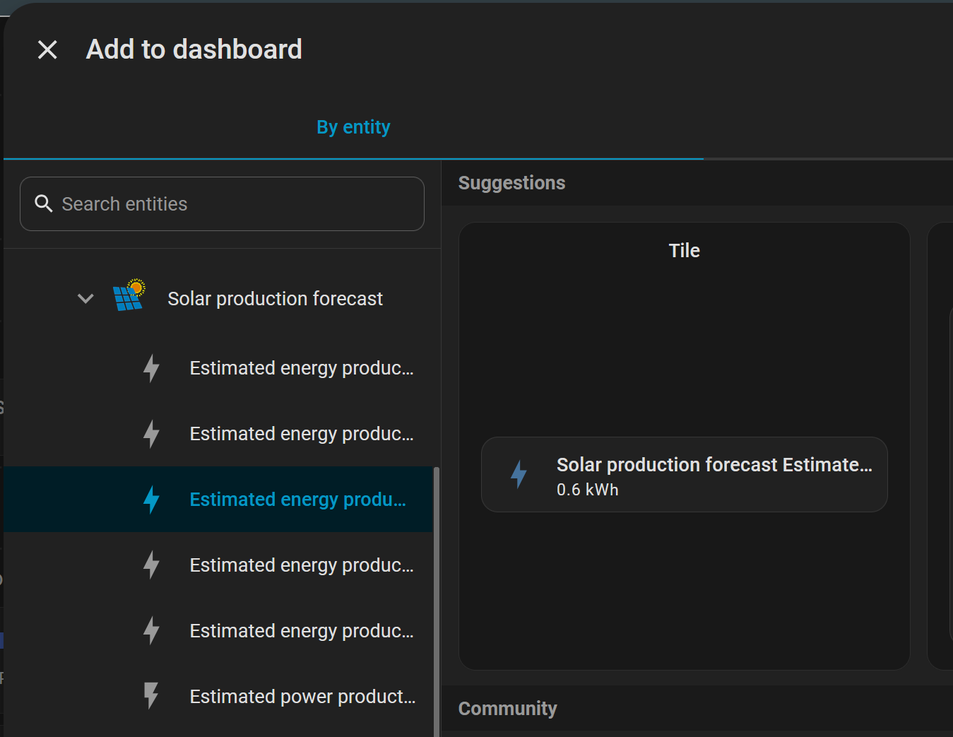

Cannot see full sensor name
Completely new to home assistant, been using it for literally only a few days.
I’m trying to add something to the dashboard, not entirely sure what I am looking for, so I am hoping the name of the entity would tell me what I need to add. Again, only been using this tool for a few days, so it is all quite new. And for now also temporary, as I am running HACS off docker to learn its capabilities.
So when I try to add an entity to a dashboard, specifically in this case from Solar production forecast, I cannot see the full name of the entity. The names are cropped everywhere and all I can see off its name is the part that is least meaningful… names are cropped in the list, cropped in the suggestions, even cropped in the actual displayed dashboards unless you make them wider (but you can see the full name if you hover over them with the mouse).
Is there any way around this?

I think you may have missed the point :slight_smile: The cropping IS the issue.
Anyway, I gather the solution from your answer is to rename the sensors to remove all the extra I don’t need for display and completely disable the sensors I don’t need.
Thanks!
