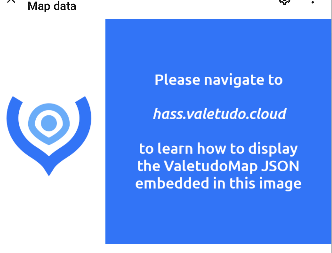

But, the map is displayed as a PNG (saw it in camera.valetudo_roborock_map_data, it as a property : entity_picture: >- /api/camera_proxy/camera.).
Also, importing this map in my dashboard results in showing this image :
Also, on Valetudo side, I have enabled everything possible to be sent through MQTT , including map data
Can anyone help me please ?
