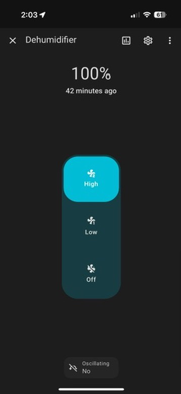

In the Tuya/Smart Life app (and on the device itself), there are three fan speeds: Low, Medium, and High.
In Home Assistant, I only have “Off”, “Low”, and “High” options exposed, but the behavior isn’t correct:
  • Low speed works fine (percentage: 50).
  • Medium speed works when I set percentage: 100.
  • High speed doesn’t work at all. When I set it to high manually on the device, HA shows percentage: 3, but if I try to send percentage: 3 from HA, it just goes back to low.
What I’ve tried
  • Created dashboard buttons that call fan.set_percentage with values 50, 100, and 3. Only 50 and 100 work.
  • Tried fan.set_preset_mode, but there are no preset modes exposed (the list is empty).
  • Looked in Developer Tools → States. I can see that when high speed is set on the device itself, the percentage shows as 3 in HA, but I can’t set it to 3 from HA.

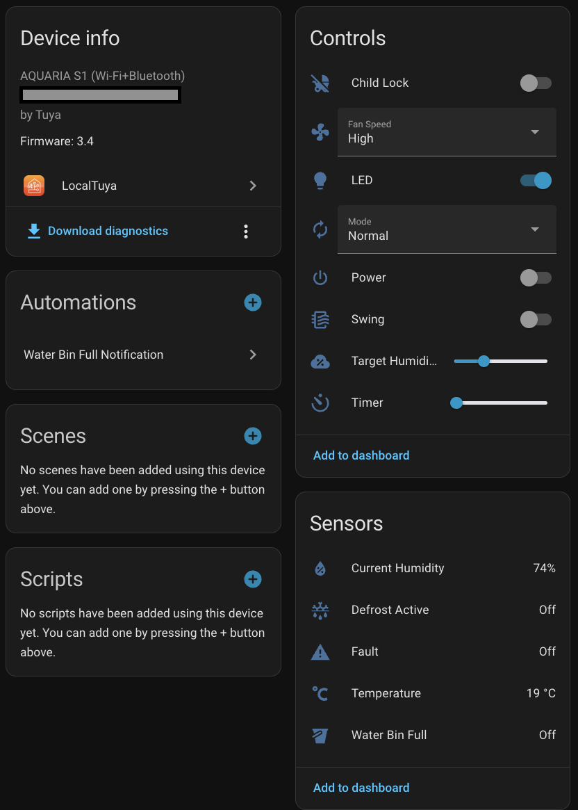

For anyone who comes across this in the future I was able to resolve using the LocalTuya integration which allows for more manual integration/customisation of devices.
:hammer_and_wrench: Step-by-step Entity Setup in LocalTuya
After you add your device with device_id, local_key, IP, and the DPS list 1,2,3,4,6,7,8,11,101,106,107,108,110, Home Assistant will start asking you to configure entities one at a time.

DP 6 → Fan Speed
  • Platform : Select
  • DP ID : 6
  • Name: Fan Speed
  • Options :
    • “1” → Low
    • “2” → Medium
    • “3” → High
