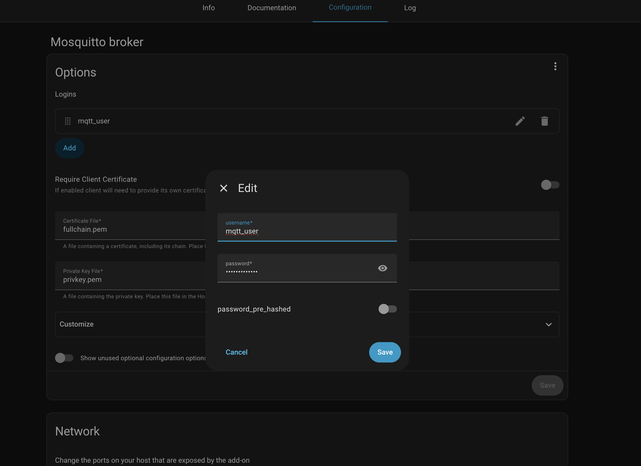

hey folks, having some trouble getting z2m up. I created a new user in HA
username : mqtt_user
password: mqtt_password
i installed mqtt broker and i put the above user name and password

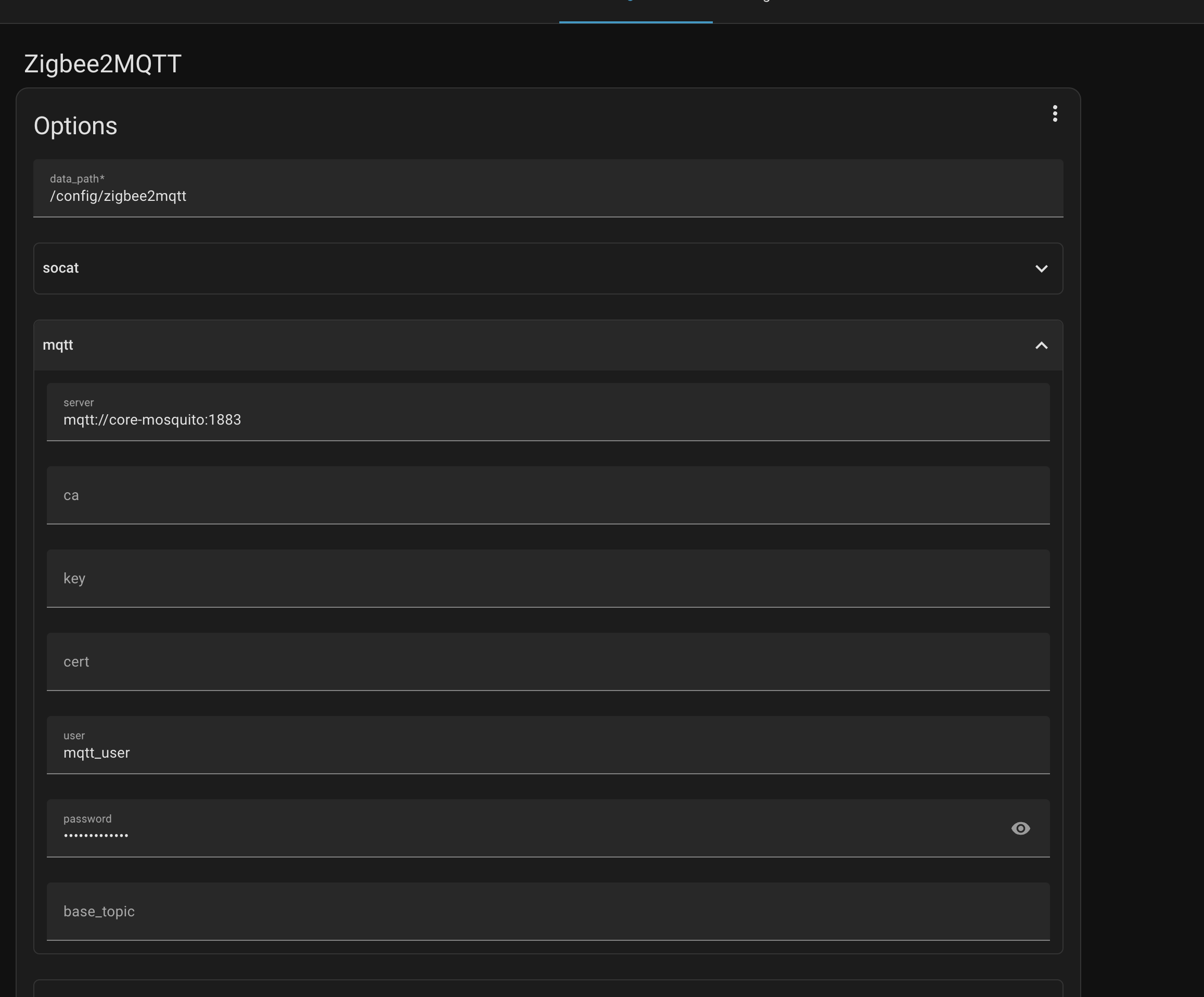

ive also included my z2m configs
i get the following error in the logs

[2025-11-09 21:56:36] info: 	z2m: Connecting to MQTT server at mqtt://core-mosquito:1883
[2025-11-09 21:56:39] error: 	z2m: MQTT failed to connect, exiting... (getaddrinfo ENOTFOUND core-mosquito)
[2025-11-09 21:56:39] info: 	z2m: Stopping zigbee-herdsman...
[2025-11-09 21:56:40] info: 	zh:controller: Wrote coordinator backup to '/config/zigbee2mqtt/coordinator_backup.json'

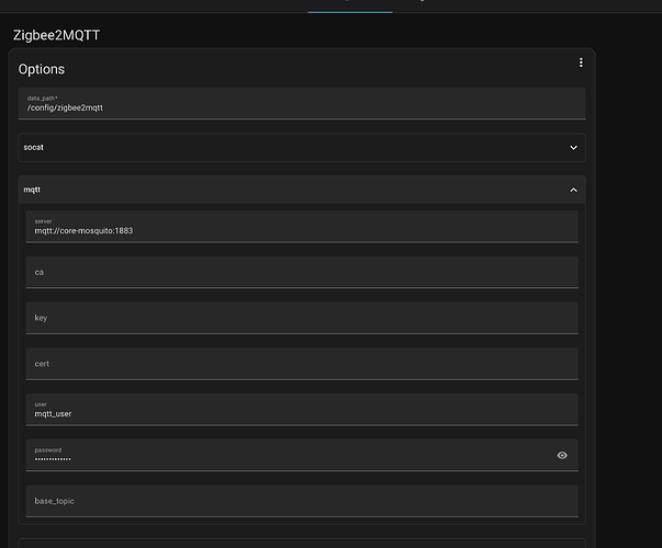

Change your Z2M config from this:
To this:
server: mqtt://<your_HA_IP_address_here>:1883
Also make sure you can connect to the broker with MQTT Explorer using those credentials. https://mqtt-explorer.com/
It was mosquitto and had 2 Ts
