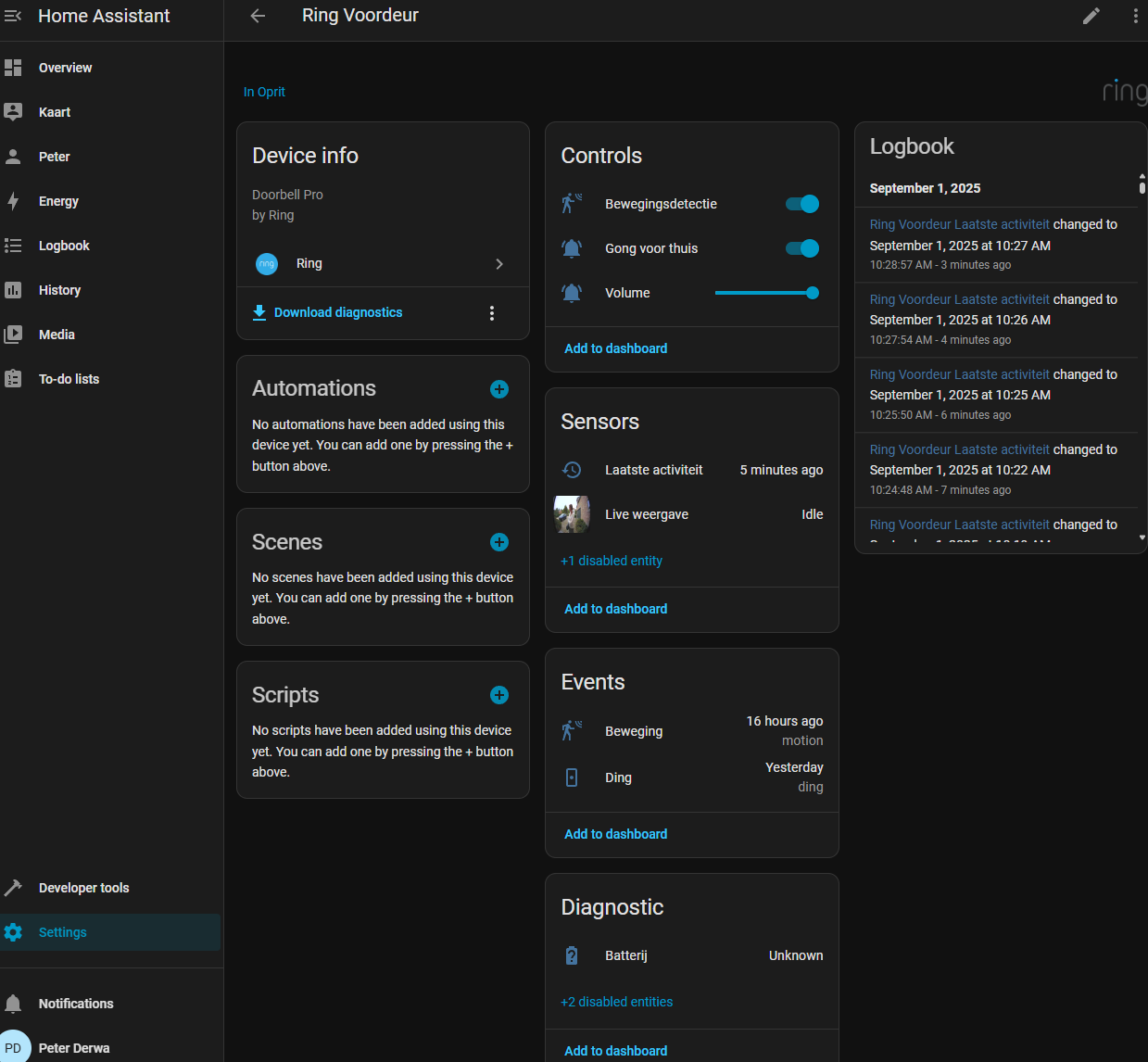

Hi all, I was trying to do the same but I think Ring is struggling with giving me the correct state. I have a wired ring doorbell pro, but this doesn’t seem to update the motion event when someone is at the door.
Events > Beweging (Movement in dutch) is not updated on actual movement.
Sensors > Last Activity is updated, but I don’t think this is actually useful since this also triggers street movement, like a passing car.
