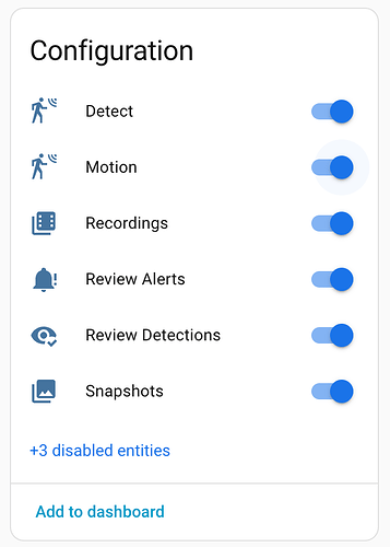

My config is working fine, I have been trying for hours to find out how to turn off recording from an automation. I have tried every entities, nothing does the job.
From Frigate I can click on the top right buttons and turn on or off recordings, snapshots etc.
2026-02-12 06:53:05.682897403  [2026-02-12 14:53:05] frigate.comms.dispatcher       INFO    : Turning on recordings for entry
2026-02-12 06:53:07.404250331  [2026-02-12 14:53:07] frigate.comms.dispatcher       INFO    : Turning off recordings for entry
2026-02-12 06:53:09.950071212  [2026-02-12 14:53:09] frigate.comms.dispatcher       INFO    : Turning on snapshots for entry
2026-02-12 06:53:10.932716164  [2026-02-12 14:53:10] frigate.comms.dispatcher       INFO    : Turning off snapshots for entry
This changes are not reflected in the Configuration sections of the device
I can click each switch, they go back on after a second, and no feedback in the Frigate logs.
