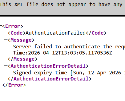

What do you get when you put that URL in your browser (or just click on it)?
You have to see at least this:
