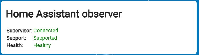

I also checked the health of my Supervisor and it is supposedly healthy.

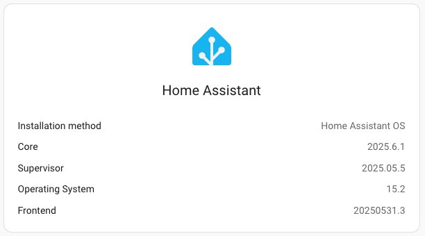

Here are the details of my system.
