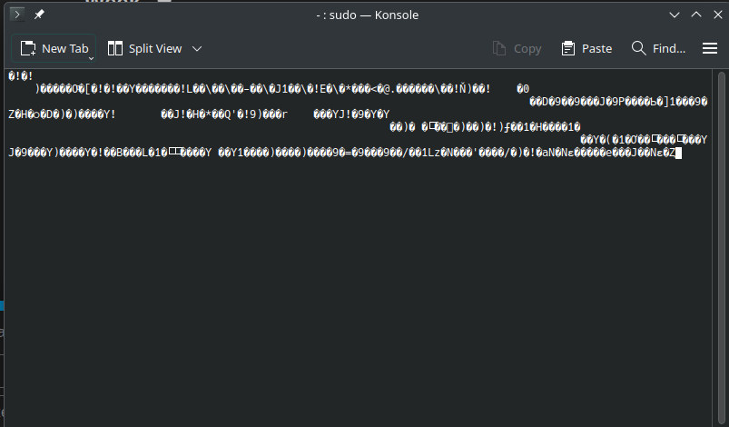

However, i have not the screen that i assume i need to have but a lot of symbols and i can’t use the console.

I have applied the tutorial here below :
Serial console to debugging
So, if i understood well the quesiton, te excatly command is:
screen /dev/ttyUSB0
Thank you in advance for your help
It says to use screen /dev/ttyUSB0 115200 though. What you see can be caused by a wrong BAUD rate.
you are right, i miss the baud rate.
