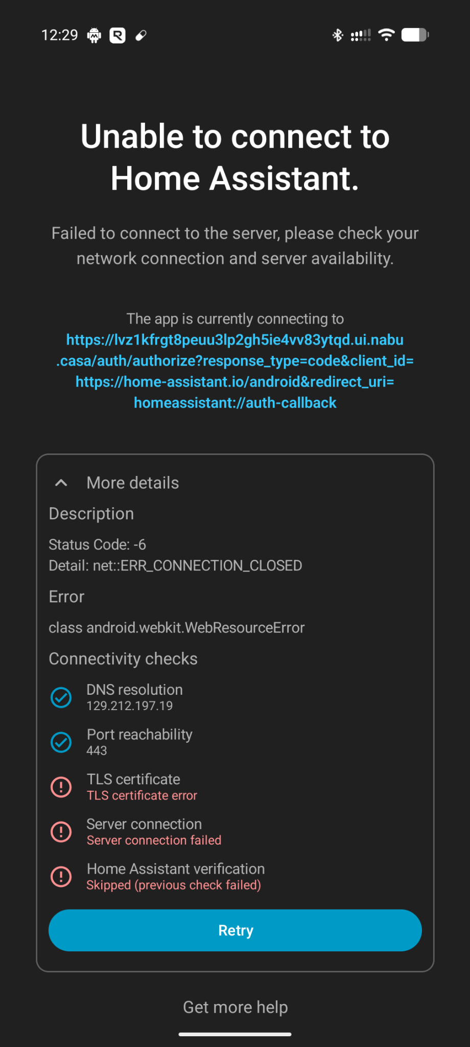

I can get in via my local IP, but not through Nabu Cloud. Says loggen in but not connected, and the android app says there's a TLS certificate error, my SSL is good until August. This was all working fine until I installed the update this morning.

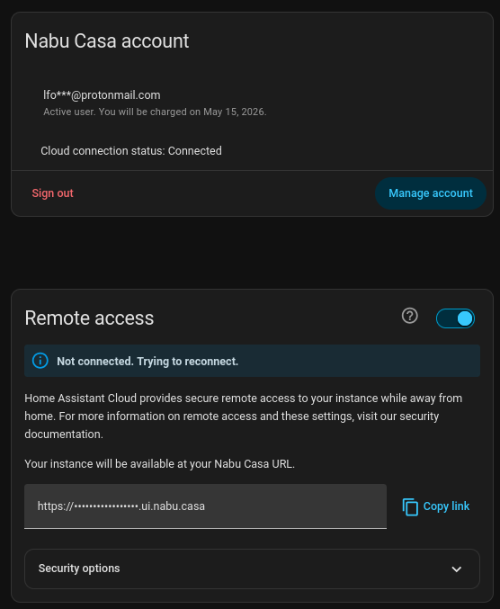

I tried reverting to a backup from yesterday, which doesn't actually roll it back. I hit restore, HA reboots, and I'm still on current when it comes back up. When I disconnect Cloud and re-enable it, for it'll say logged in and connected, and then quickly reverts to logged in and not connected.

Yup, both logged out/in and did the Reset cloud data in between. Now it says cloud is connected, but the remote access box below it says it's not connected, which is says connected at first, but then goes to that.

One thing I noticed though is my Let's Encrypt integration is gone, I don't think that would affect it working through the cloud address, but weird as I never removed it. Also don't see it listed anymore if I try to add it, I had my local IP through SSL as well and that seems to be gone now. Something went stupidly wrong on this one!
