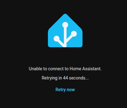

I’ve been struggling for weeks with a persistent issue connecting to my Home Assistant instance through Cloudflare Tunnel only on Chromium browsers. I’ve tried everything I could find on this forum and elsewhere, but the connection still fails when accessing from a Chromium web browser via my public domain.

And in the browser console, I see:
POST https://ha.domain.com/auth/token 400 (Bad Request)
However:
  • The Android Home Assistant app works perfectly with the same public URL.
  • Accessing directly via local IP also works.
  • Only Chromium browser access via Cloudflare fails (it works fine in Firefox).
The weird thing is that it will once in a while works for no reason and after a cache clearing or a computer restart, it will failed to connect again!
I also have Websockets errors in web console even though Websocket is enabled in Cloudflare dashboard.
