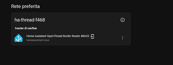

i just bought a ZB-T2 and add it on HA as Thread Board Router.
HA is in the same VLAN of my IOT stuff and i’m using the mobile app on a smartphone in the same VLAN. Ipv6 is enable and also nat64.

Maybe more intresting is the matter log.
OK, so now you’re seeing a Thread network. That’s good!

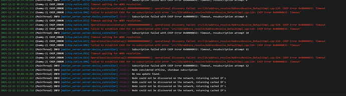

This is the tail of the Matter Server log.
I already tried few times to change the thread network with a new one, and repeat the operation. But, as i said, a matter over wifi plug device was already discovered, so mdns ipv6 and stuff should works. At this point the culprit seems something broken on my phone.
Thread networking is a much more difficult technology, so …
The general problem with Matter over Thread is the credentials in the mobile device are incorrect. Android has the problem with only using the first credentials it finds, and if you tell Android to change, it really doesn’t work, you have to remove not only the cache, but also the storage in Google Play services to remove any Thread credentials. Also be aware that anytime you change Thread networks/reset the Thread network in HA, then new Thread credentials are generated in HA and this has to be sync’d to the Android mobile device that has already had its thread credentials cleared out.
BTW, the log is show subscription failures which usually only happens to devices that were actually commissioned. What you should see when doing a new device commissioning is the logs showing that Matter is going into commissioning mode

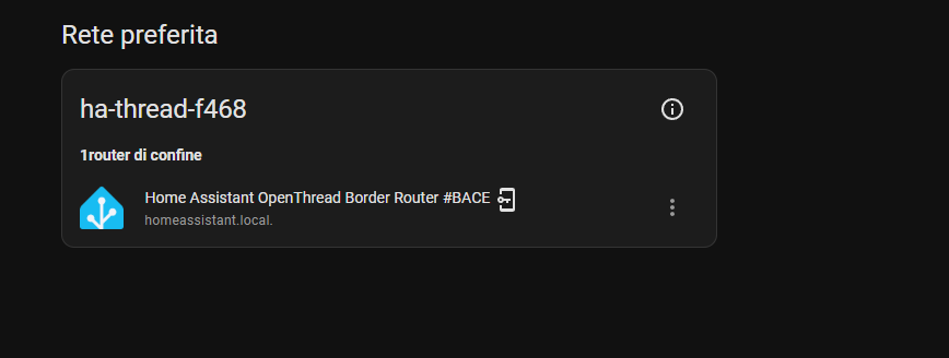

After hours messing with my router settings, proxmox network adapter settings, reconfiguring matter server, Thread Border Router add-on, clearing data & cache of Google Play Services I finally got it going.
The “matter is currently unavailable” error is originated after wiping Google Play Services on the Android device. Looks like an update is also wiped for the Google matter service that the HA companion app uses to scan QR codes & commission devices, which triggers the “matter is currently unavailable” error.
Here’s what worked for me to be able to commission devices via the ZBT-2.
  1. Configure the ZBT-2 OTBR network and set as the preferred network with credentials
  2. Wipe the Google Play Services storage & cache to clear old credentials of the border router network stored on the Android device
  3. HA Companion App Settings → Troubleshooting → Sync Thread Credentials
  4. Scan any matter QR code with the Camera app and tap the QR code action to trigger Google Play Services to update the matter commissioning service
  5. Go back to the HA companion app & commission matter devices via the ZBT-2 network
