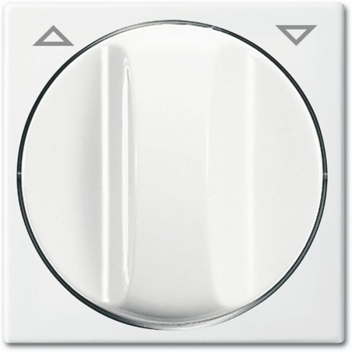

I’m trying to add the Fibaro Roller Shutter 3 to Home assistant. This device was meant to make our (dumb) sunscreen smart so we can control it from our phones/HA, which has this kind of switch to control it.

However, after this step we are confused. No devices are added and turning the switch on, turning it on 3-5 times quickly in a row (this is the S1 I think?), holding the B-button for 5 or 10 seconds or clicking the b-button quickly 3 times (after which a green led will start flashing for a short while), does nothing.
