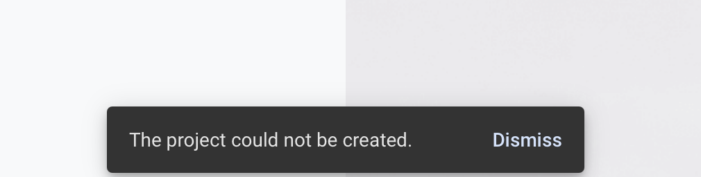

Can't add google nest paid API anymore
All of the sudden, I cannot reach my google nest thermostats anymore via HA>
I ended up going back to a back-up of two days ago, HA ask to re-identify myself on the google API (the 5 USD one) So I did, it said thank you, but still refuses to link to the previously set thermostats.
I deleted the entities and started over with all existing credentials, I tried about 5 times without any result.

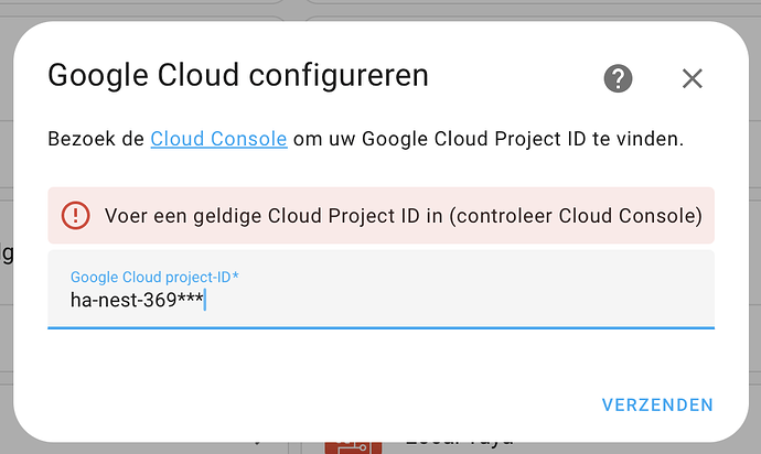

I keep up ending with authenticating via the external google links, it accepts, I need to link back to my HA installation URL, after that HA keeps returning with an error that i need to enter the correct prject ID
I keep doing this but then refuses.

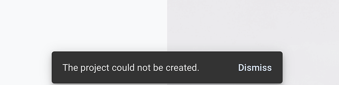

I created a whole new project in google and started from scratch, following each and every step, but keep returning in the same loop as above.
What is going on?

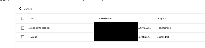

Did you remove the existing Application Credentials from:
  • Settings
  • Devices and Services
  • Top Right 3 points

I did, and even added new credentials in HA first. (New OAuth user)
For whatever reason I keep returning to the “first” screen to enter the proper cloud project id.
Which I did in the first place, why would it continue with the setup otherwise.
I deleted the devices project, and started a new one
SO frustrating!
I feel your frustration. A few months ago, I deleted the Integration by mistake and it took me days to get it back.
I can try forever but nothing changes.
Even if I deleted the topic, the loop I am in does not change, nor do the errors

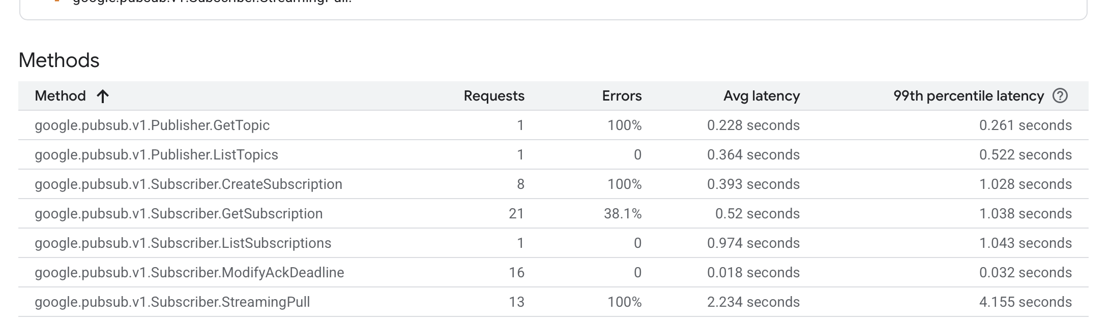

Logger: homeassistant.components.nest.config_flow
Bron: components/nest/config_flow.py:281
integratie: Google Nest (documentation, issues)
First occurred: 11:28:24 (9 gebeurtenissen)
Laatst gelogd: 12:10:54
Configuration error creating subscription: Failed to create subscriber ‘projects/ha-nest-thermostaat-/subscriptions/home-assistant-jL9Zotpz0p’ (cloud project id incorrect?)
Configuration error creating subscription: Failed to create subscriber 'projects/ha-nest-thermostaat-
/subscriptions/home-assistant-6csF7lsnga’ (cloud project id incorrect?)
Configuration error creating subscription: Failed to create subscriber ‘projects/ha-nest-thermostaat-/subscriptions/home-assistant-nmPeTNIX2U’ (cloud project id incorrect?)
/subscriptions/home-assistant-RqVToyKnFu’ (cloud project id incorrect?)
Configuration error creating subscription: Failed to create subscriber ‘projects/ha-nest-thermostaat-***/subscriptions/home-assistant-dwThQJfpoQ’ (cloud project id incorrect?)
