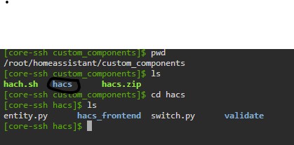

I downloadd the script and run it manually but get an issue wite the “wget “https://github.com/hacs/integration/releases/latest/download/hacs.zip””
downloadd the HACS manually and remove the lines that erase the old one ,the script is running and I get
(it looks slike not all the files from the zip are there )
but still cant see it in the integration list
I clear the Browser reboot etc …
anyone can help (my be my HA got configuration issue?)
after open the zip file and copyed it to the directory i can see the HACS
but when tring to install it i get “could_not_register”
