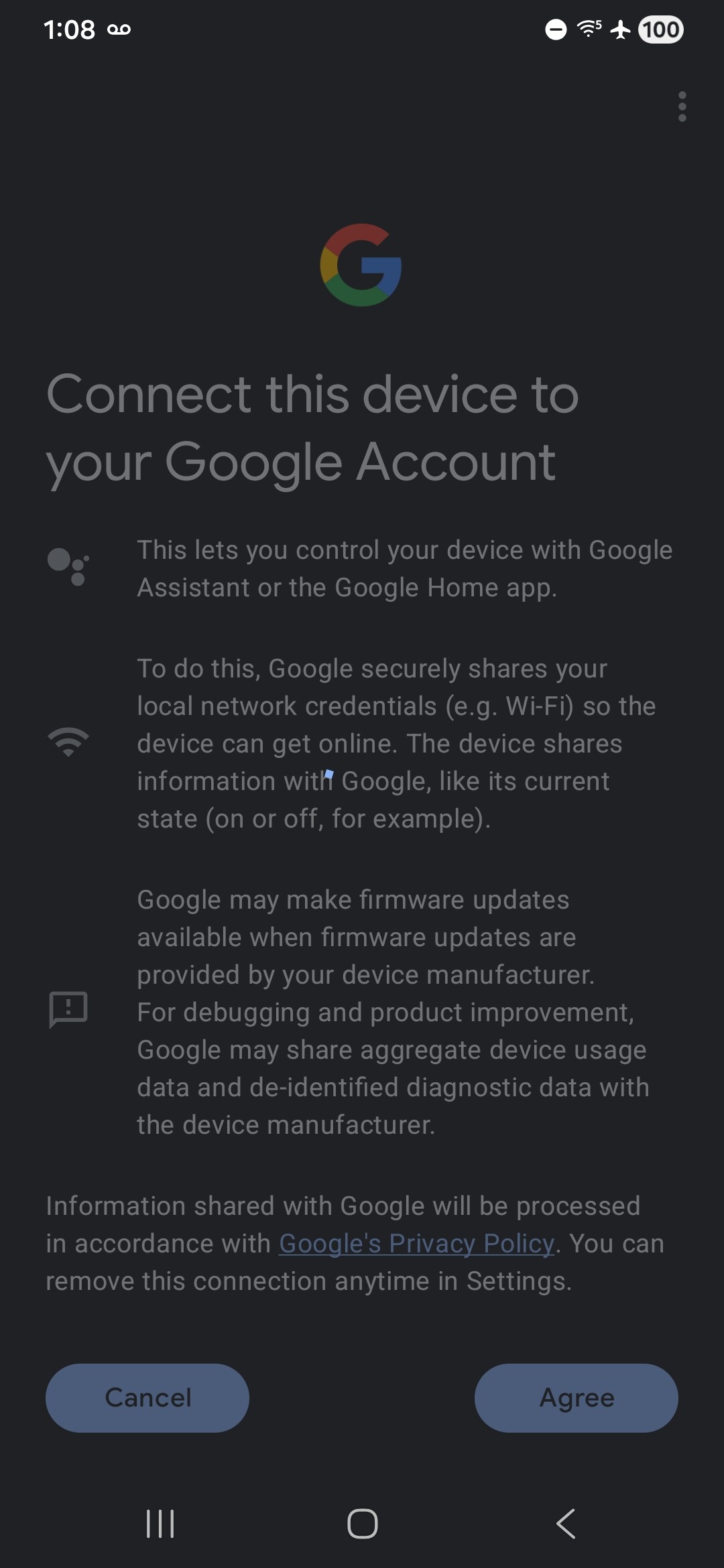

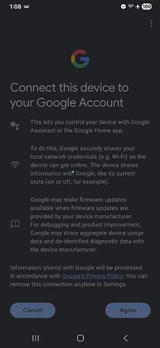

Still looking for help with this. Also, another thing telling me it's a Google issue: I added this HA App in order to control via Google Assistant: GitHub - RiDDiX/home-assistant-matter-hub: Publish your Home-Assistant Instance using Matter. · GitHub. I am not able to add it via Google Home on either of 2 Android phones, using 2 separate Google accounts. I can add it via Smartthings without issue, though in this case Multi-Admin does not work and suffers the same issue. It hangs on "Connect this device to your Google Account".
