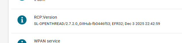

OTBR GUI is also showing proper radio firmware:
