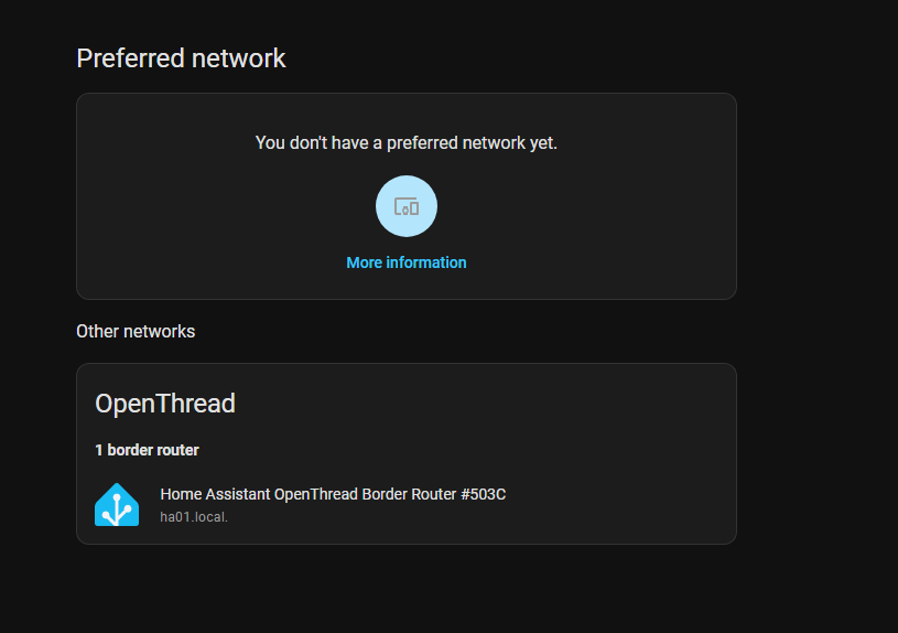

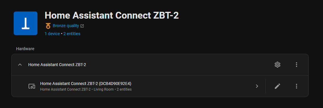

I just bought the Home Assistant ZBT-2 antenna, and enabled the Matter and OpenThread border router in HA - but i cant add my IKEA MYGGSPRAY to HA.

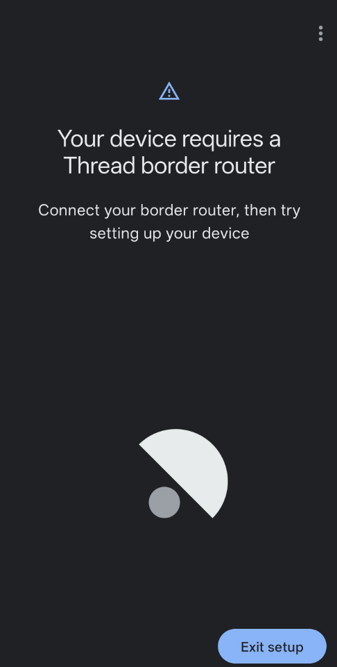

The sensor starts lighting up, and i get a bluetooth notification on my phone. When scan the QR code, it says it wants to connect it to the Home Assistant app - and then after about a minute or so, it fails, stating that i need a Thread border router - which i have?
What obvious step, am i missing here?

You need to sync the credentisld with your HA setup. On your phone open HA | Companion App | Settings | Troubleshooting | Sync Thread Credentials.
Then check that your preferred Border router has a little lock symbol and try again to connect.
You beat me to it :slight_smile:
Followed these guides, and that fixed it
