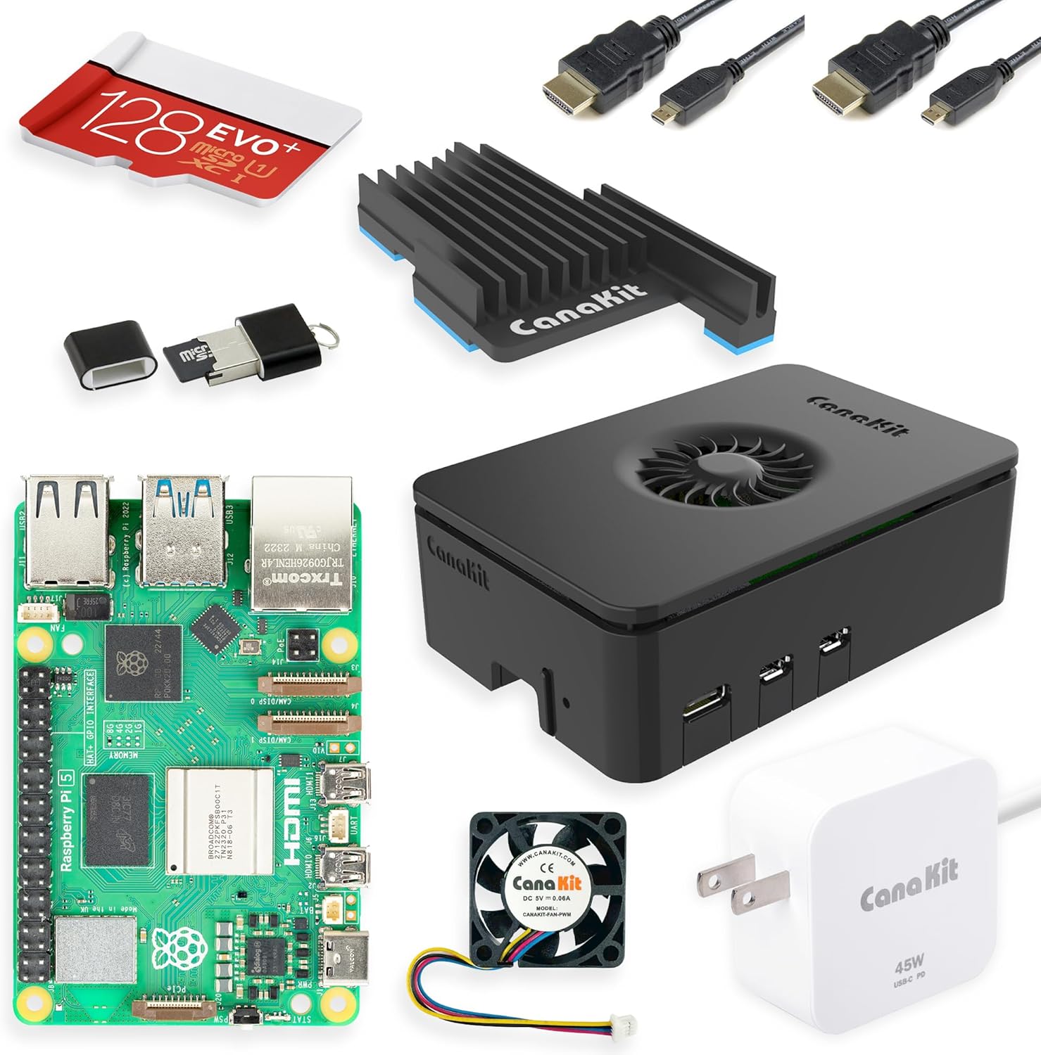

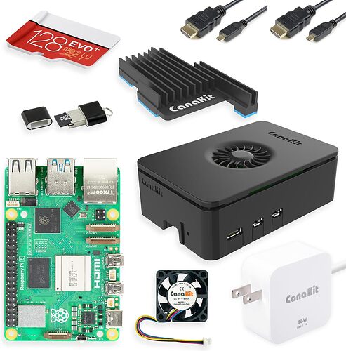

Created an account just to add my story here too and confirm the fix. Freshly flashed HAOS on a brand new raspberry pi 5, and a Sonoff zigbee 3.0 dongle “Failed to probe USB device”. Nothing else connected, nothing else configured. Just an out of the box pi, HAOS and the Sonoff zigbee dongle.
Solution was indeed to put it on an unpowered USB hub with a ~1.5 foot (I think mine might be even shorter) cable and trying again.
Never would have thought that would work in a 100 years.
since others have asked about the raspberry pi kit, here is what I bought:
HAOS info:
  • Installation method: Home Assistant OS
  • Core: 2025.5.3
  • Supervisor: 2025.05.3
  • Operating System: 15.2
  • Frontend: 20250516.0
