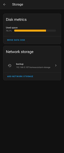

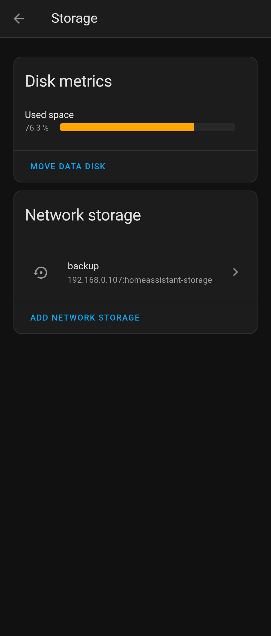

I have a home assistant OS installation. Since 2 weeks ago I can’t make backups, and automatic backups are not working.
I have selected Network storage and Home assistant cloud.
Everything seems to be OK in the Network storage
However, I constantly get a warning of backups failing, and all that I can see in the logs is this:

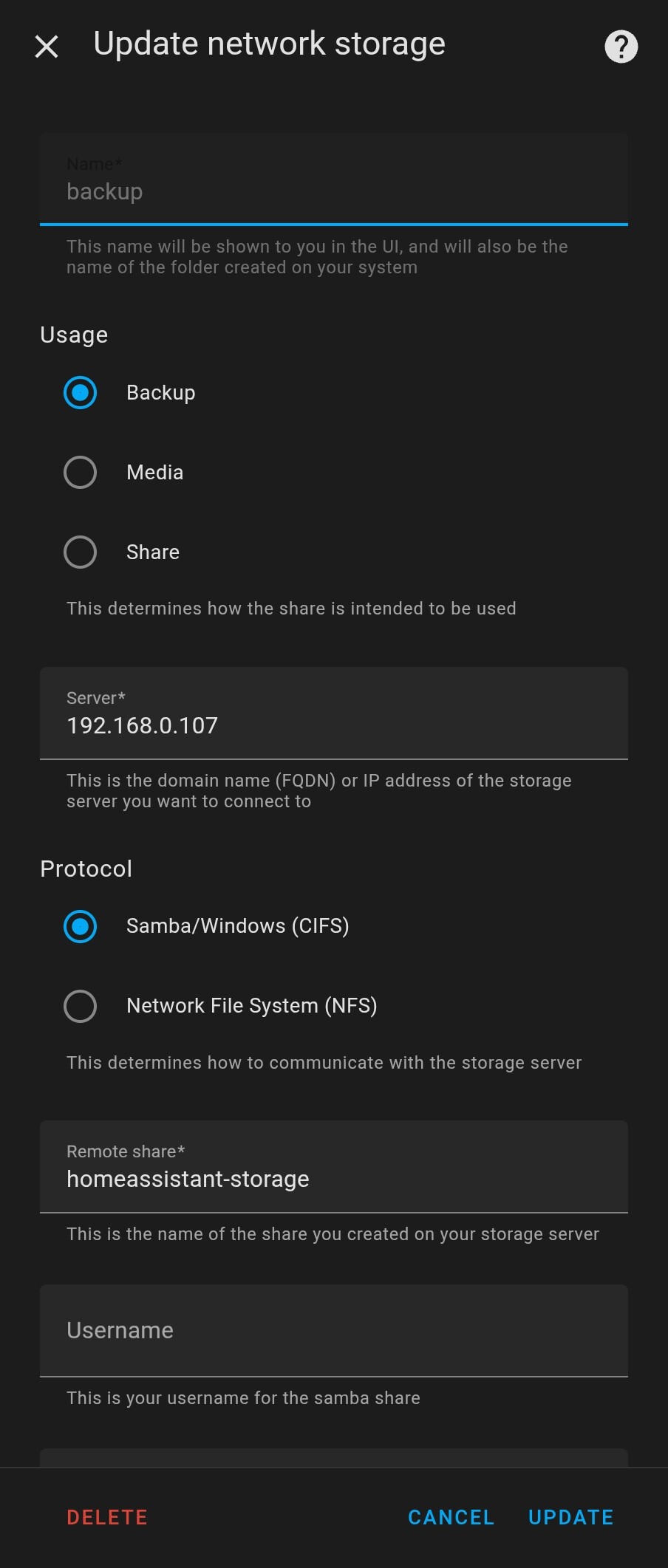

Are you sure the location on the network is correct? A : after an IP usually defines a specific port. Try with / instead. I don’t use this myself so not sure.
That is how home assistant represents it (not following standards IMO so it can be confusing).
You don’t input that string directly, you configure it through an UI
