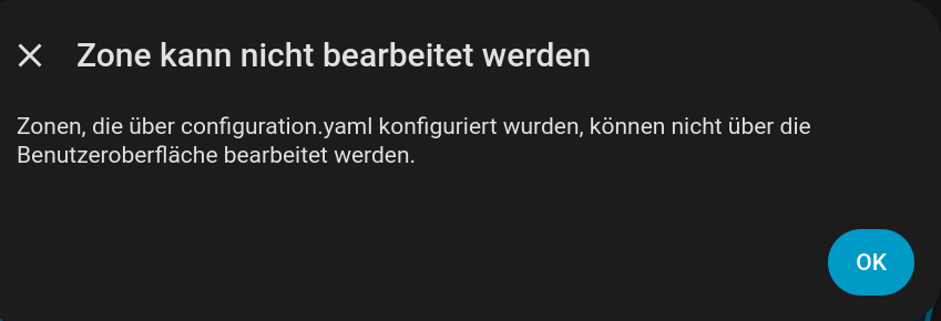

I’m trying to expand my home zone. I read in a post on another post that this should now be possible via the UI. Unfortunately, that isn’t the case for me. When I try to change the home zone under the zone settings, the following message appears: “Zone cannot be edited
Zones configured via configuration.yaml cannot be edited via the user interface.”

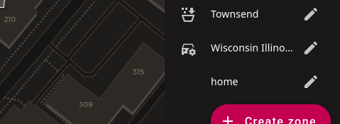

Here’s mine and the commented stuff I took out back then. Home-Assistant-Config/homeassistant.yaml at 034bd2778e116466bf1c80ac5a2897c3970143e6 · SirGoodenough/Home-Assistant-Config · GitHub
I can do home zone stuff in the UI.
Thats it! Many Thanks. I was able to increase the radius.
