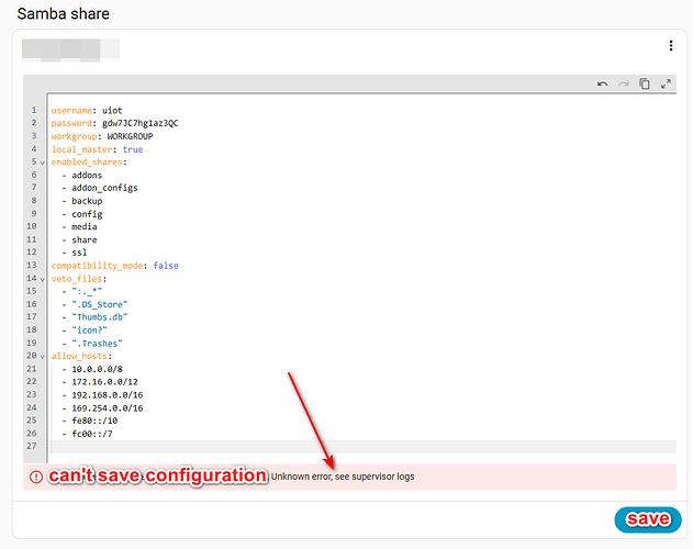

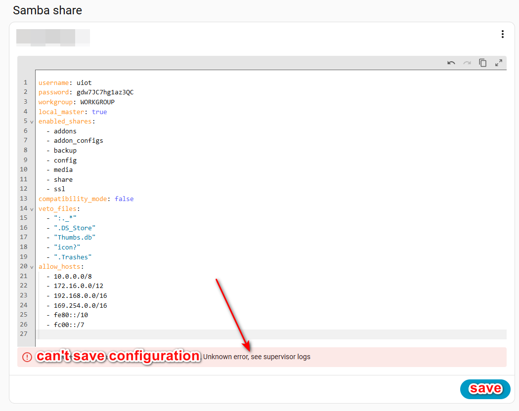

Tried this:
username: uiot
password: gdw7JC7hg1az3QC
workgroup: WORKGROUP
local_master: true
enabled_shares:
- addons
- addon_configs
- backup
- config
- media
- share
- ssl
compatibility_mode: false
veto_files:
- ":._*"
- ".DS_Store"
- "Thumbs.db"
- "icon?"
- ".Trashes"
allow_hosts:
- 10.0.0.0/8
- 172.16.0.0/12
- 192.168.0.0/16
- 169.254.0.0/16
- fe80::/10
- fc00::/7
Error is the same.

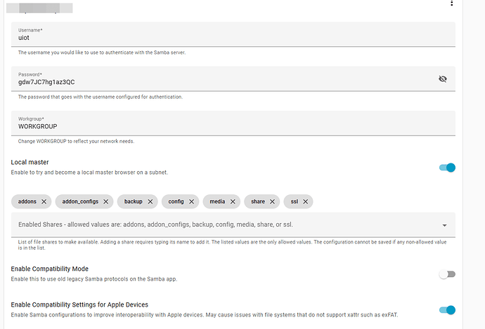

Then try to install Samba Share again , and show a picture of your Configuration Page, Not a file, but where you Edit Your Settings
Or Install an “Older” Version of Samba Share, which is compatible with your OS/CORE
poddex
March 8, 2026, 8:56pm
7
Ok, updated Core and OS. Reinstall SAMBA.

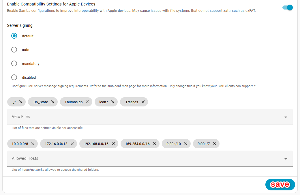

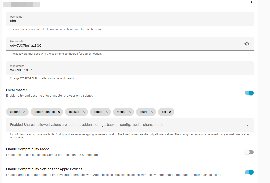

Here are a shots:
And when I hit Save button, I gen the same error “Can’t save configuration”. What am I doing wrong?
