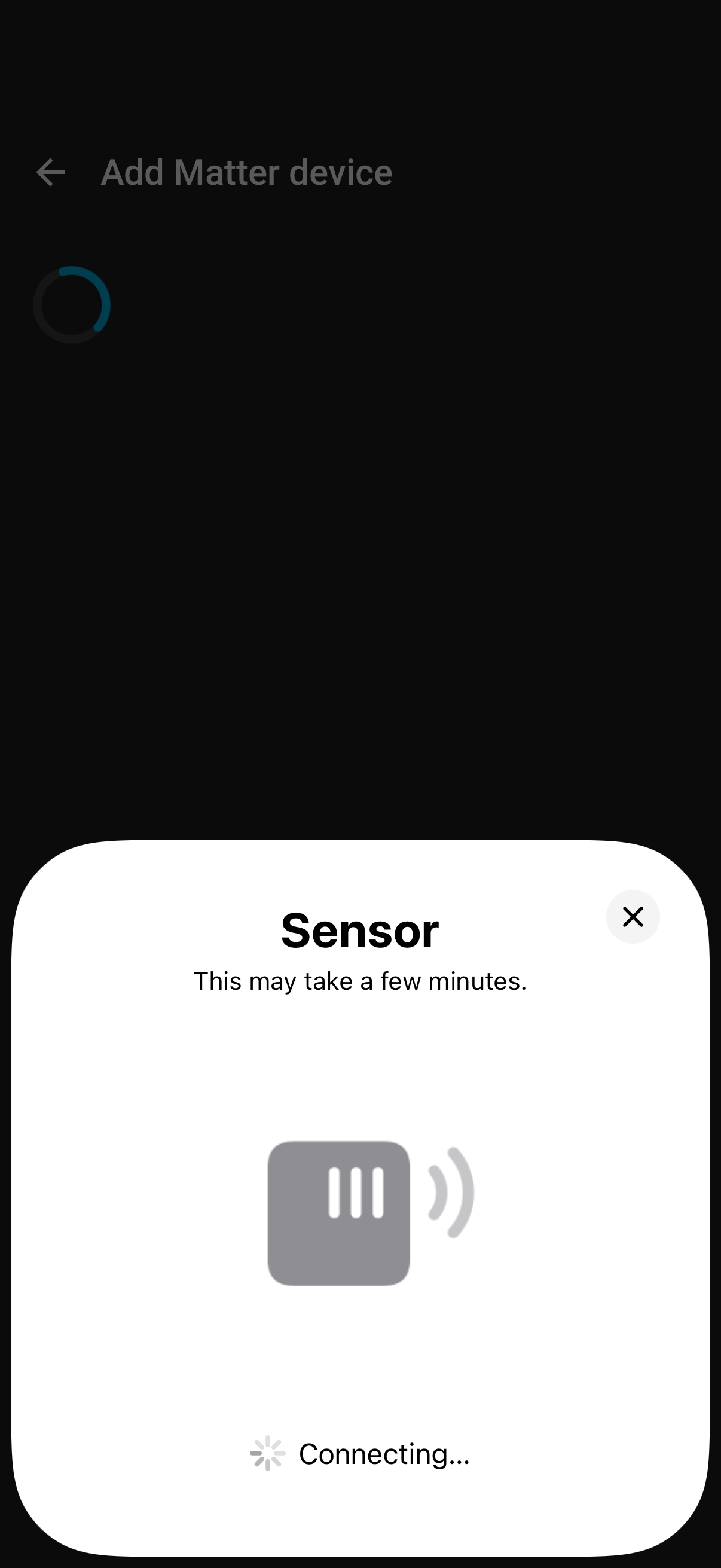

I'm trying to connect the IKEA MYGGSPRAY motion sensor to my Home Assistant Green. I've configured (I think) a ZBT-2 as a thread border router.
The problem comes when trying to connect the motion sensor.

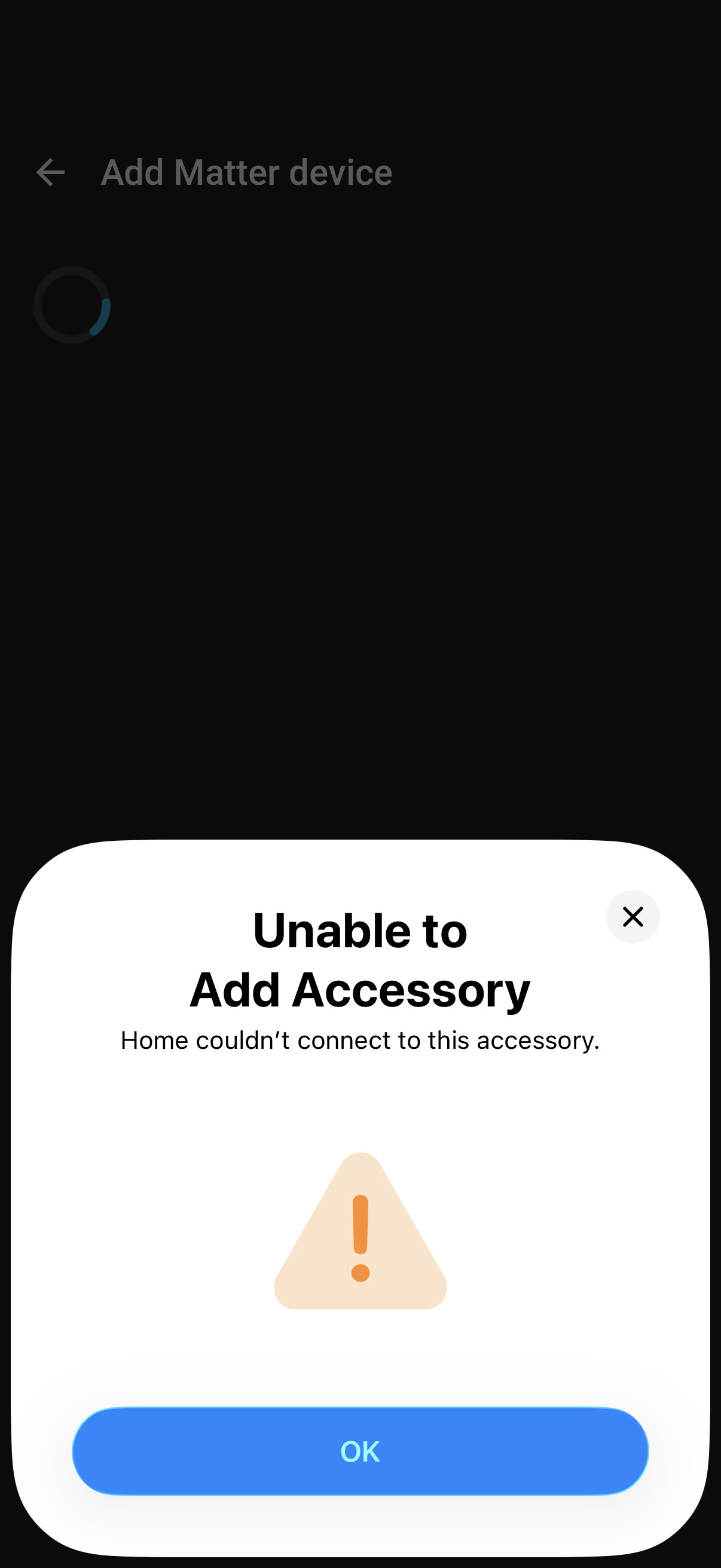

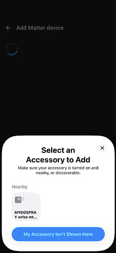

When adding a new matter device I choose to connect using code instead of scanning QR-code and the MYGGSPRAY shows up. However after trying to connect for a few minutes an error shows up "... could not connect to this accessory."
I've tried to do some troubleshooting and made sure that IPv6 is set to automatic and my compaion app credentials are updated, but now I'm stumped.

Thank you, I enabled IPv6 in the terminal:

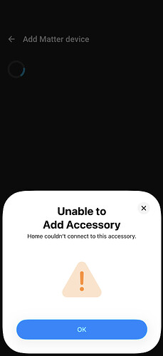

but I still got the same message after a few minutes of trying to connect. "Home couldn't connect to this accessory".
I'm trying to add it to my HA, I have a HA Green with a ZBT-2 connected. Sadly I don't have any Apple routers, (I'm starting to think I should've bought that instead of the ZBT-2 to add matter over thread products).
