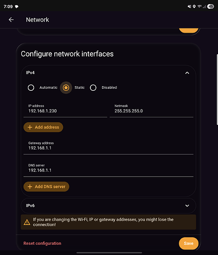

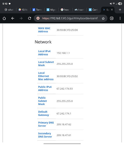

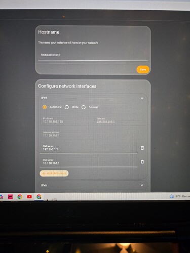

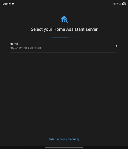

Hello, i am very new to HA (like less than a few months) and still learning how everything works. im trying to switch my router from the spectrum router they give you to a Orbi RBE371 and am having a hard time finding out how to get HA and everything to switch over. im finding some info like, they say to switch the ip to static then switch the router and put the old IP adress in the new router but that isint working. maybe im changing the wrong IP address in the wrong setting or something? I have very limited knowledge on the IT side. The screenshot is of the IP address before switching the router. The photo of the computer screen is after switching the router. I was able to load into HA dashboard but not control any devices. The I tried switching the IP address back but now i cant connect to HA at all. I also tried logging out of the HA app and now when i try to log back in to the http://192.168.1.230:8123 that it gives me to try and use i just get a blank screen.
Your network before was 192.168.1.x and after is 10.168.168.x
Completely different networks, so no, I am not surprised that anything isn’t working.
Go to your new router and change its local IP to 192.168.1.1 and everything should be back to normal.
I switched it back to the 192 after realizing it was a different ip and i went from being able to log into home assisistant but not control any devices to now not being able to log in to home assisistant at all. So now i dont know how to get into home assisistant to change the ip

Here is the router and what it says when i try and connect to the HA app

Ok so i connected my laptop with a hdmi cable and was able to log back in to HA to be able to reset the configuration in the (configure network interfaces) setting. So now i have control of HA and everything back. But the main problem is still that i cant get it to connect when i switch to the new router.

If you had this all working before on the old router, then the only logical change would be that the new router is assigning a different private IP range to your local network. 10.168.168.x from your images above.

Setting your Home Assistant IP to a static value would not help at all if, as I suspect, your new router is assigning your local private IP range to a different network. 192.168.1.x is not the same network as 10.168.168.x (as shown in your original post.)

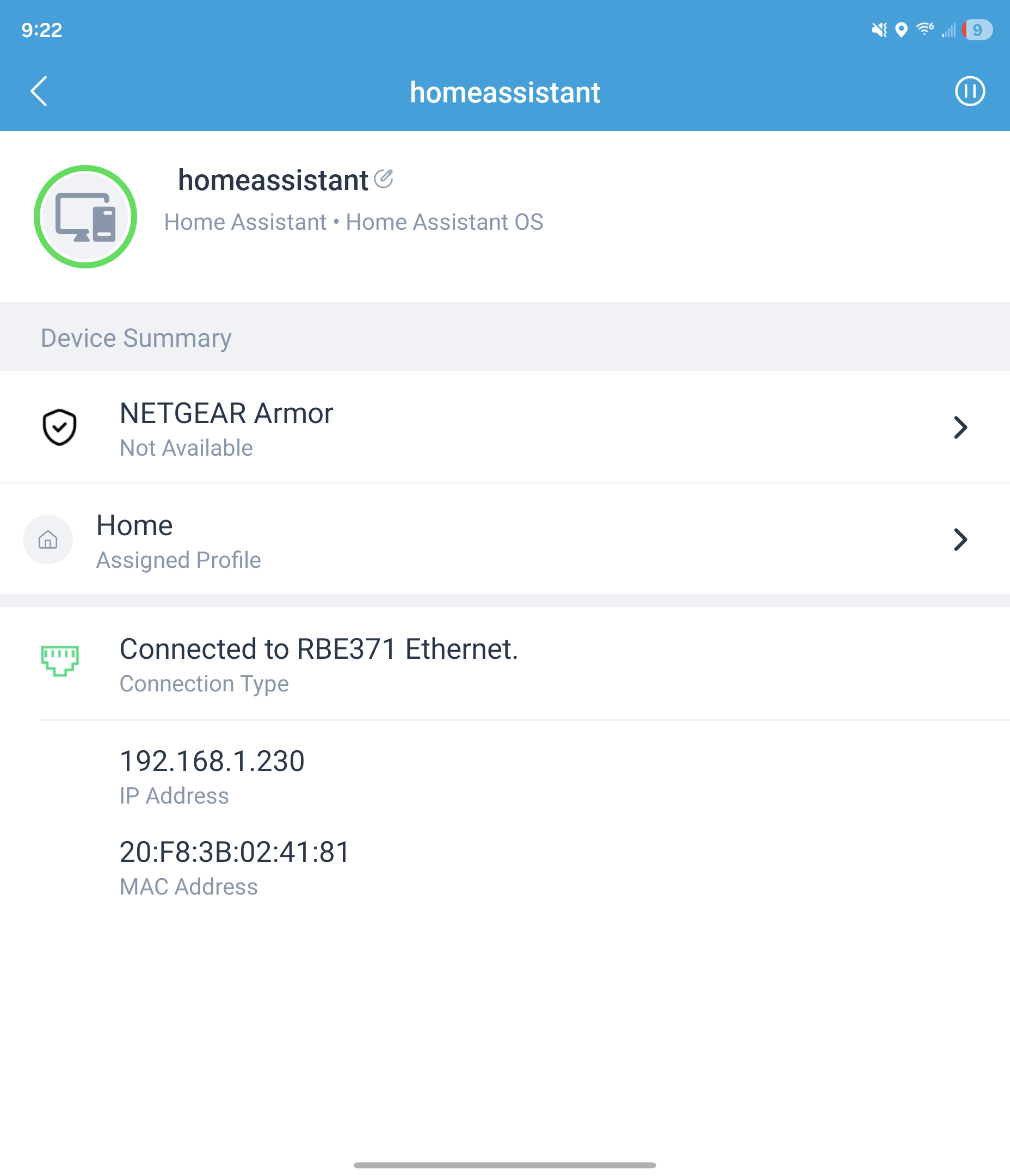

Ok so that worked with getting home assistant to connect to the new router. But i cant control any of my devices now. I tried to re add them in HA but they cant be found.
